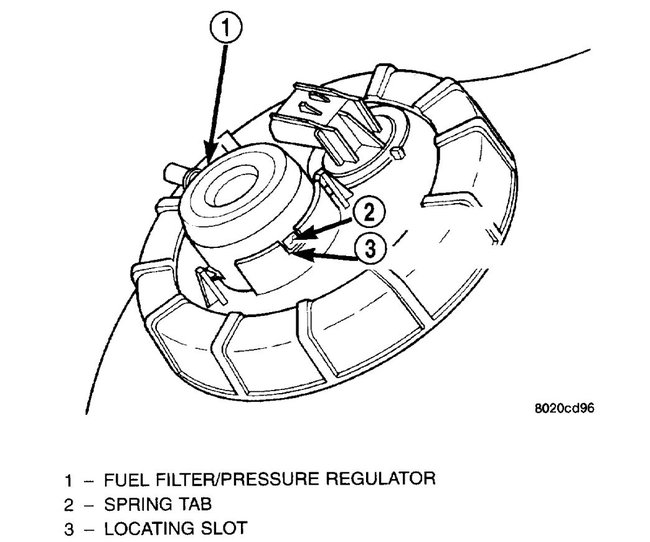

I was wondering where it is and how I change it
Tuesday, November 24th, 2009 AT 11:09 AM
12 Replies
CH112063
  • 1,320 POSTS

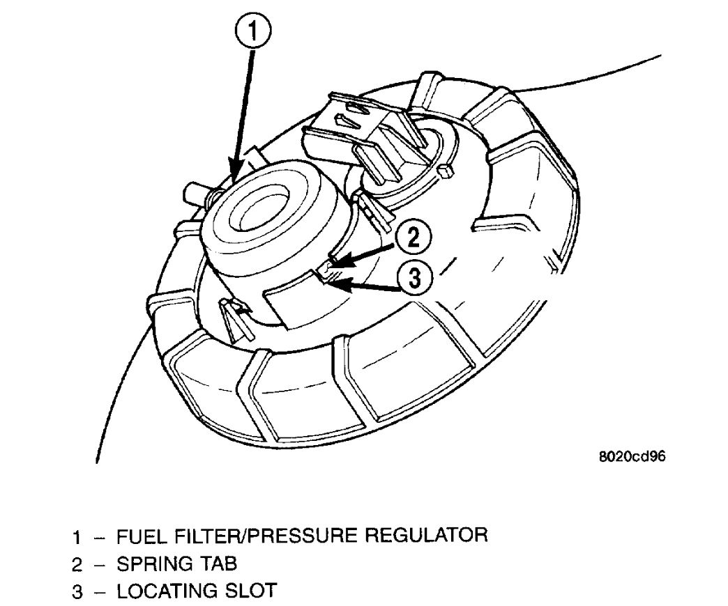

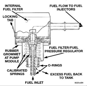

REMOVAL
1. Release fuel pressure, Refer to Fuel System Pressure Release Procedure.
2. Remove Fuel Tank refer to the Fuel Tank Removal/Installation. See: Fuel Tank > Service and Repair
3. Lower fuel tank and remove the purge line and vent line.
4. Disconnect fuel line from pressure regulator.
5. Push locking tab in from locking slot. Turn pressure regulator to unlock it.
6. Pull regulator straight up.
INSTALLATION
1. Push regulator down and into place.
2. Turn fuel pressure regulator to lock it in place. Make sure take the locking tab is in the locking slot.
3. Connect fuel line to regulator
4. Raise the fuel tank on the transmission stand.
5. Install fuel pump electrical connector into hole in the body.
6. Connect the purge and vent lines.
7. Raise tank into position and install tank straps.
8. Install the fuel filler tube and tighten the clamp.
9. Reposition the stabilizer bar and install bolts.
10. Lower vehicle.
11. Connect the fuel pump electrical connector that is in the rear seat.
12. Install the rear seat.
13. Connect the battery cable.
14. Fill fuel tank. Use the DRB scan tool to pressurize the fuel system. Check for leaks.
See diagram below

Top of the fuel tank
https://www.2carpros.com/forum/automotive_pictures/12900_ff1_1.jpg
Fuel filter and fuel pressure regulator is located on the top of the fuel pump module.

JDL
  • 16,098 POSTS
The fuel filter is part of fuel pressure regulator. The regulator is on top of fuel pump module, top of gas tank.

  • 75,992 POSTS
It's attached to the top of the fuel pump and doubles as the fuel regualtor as well. The fuel tank will have to be dropped to get to it.

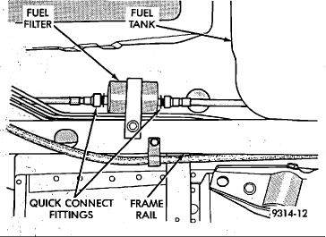

SAFIRE52632
  • 1996 DODGE INTREPID
  • 6 CYL
  • 4WD
How to change fuel filter
I have a 1996 Dodge Intrepid that wont start I have the part to fix it but I cant find were the fuel filter is located, Can u please help?
+1
Sunday, August 18th, 2019 AT 9:34 AM (Merged)
  • 75,992 POSTS
The fuel filter is located on the frame rail in front of fuel tank. The inlet and outlet ends of the filter are marked for correct installation.
JDL
  • 16,098 POSTS
Make sure there is no pressure on the line before taking anything loose. Looks like a quick disconnect fitting for the filter, not sure which type?
