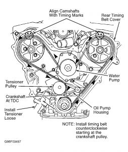

if you was told its a water pump
then the water pump drivin by the timing belt
https://www.2carpros.com/forum/automotive_pictures/99387_35_1.jpg

I'm with rowtiear about turning the engine with a bar and socket. If the engine turns, then the problem is likely to be starter, solenoid, or battery cable related. You can eliminate the belt driven accessories by removing the external belts. I've seen accesssories prevent an engine from turning over when they lock up.
The water pump is timing belt driven, and is not visible without removing the covers on the front of the engine. Is your son sure that he's looking at the water pump?
The diagram that BMRFIXIT included shows the front of the engine with the alt/ps and ac belts removed along with the harmonic balancer and front engine covers.
There should be 2 belts that are visible with the harmonic balancer. 1 drives the alternator and power steering pump with an idler as tensioner. The other drives the ac compressor with an idler as tensioner. Removing these belts is not going to show the water pump.

Check relay box it has a relay for the starter
i think water pump run by the timing belt check pic up
also do what suggested above
