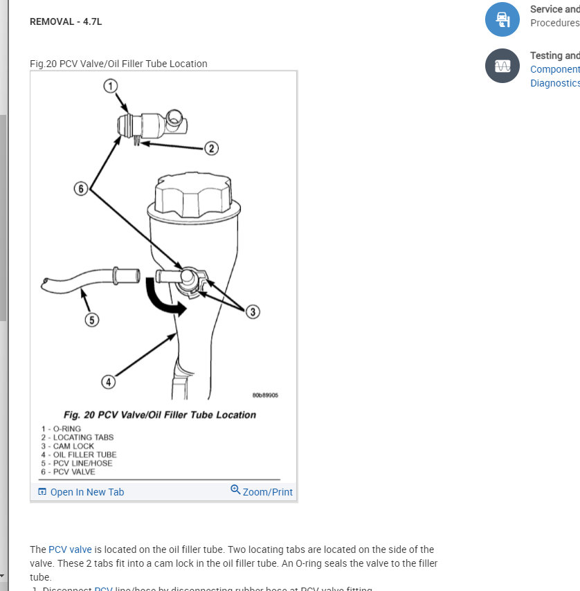

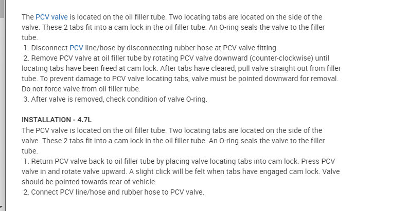

My durango is equipped with a 4.7 L v8, where is the pcv valve located?

On the 4.7L the PCV is located on the oil filler tube, so I am attaching the info below from the manual on how to replace this.
Please see the info below and let us know what other questions you have.
Thanks
