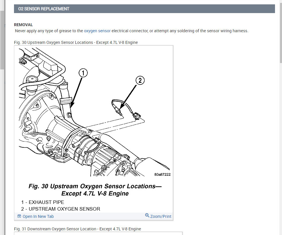

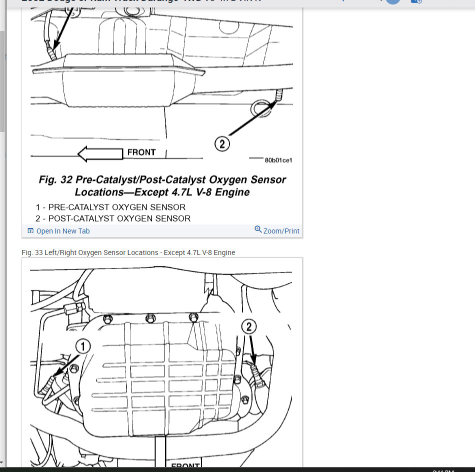

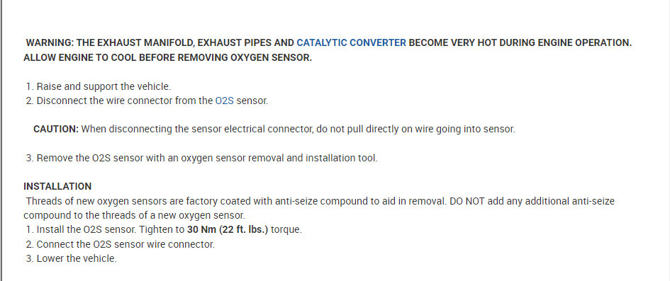

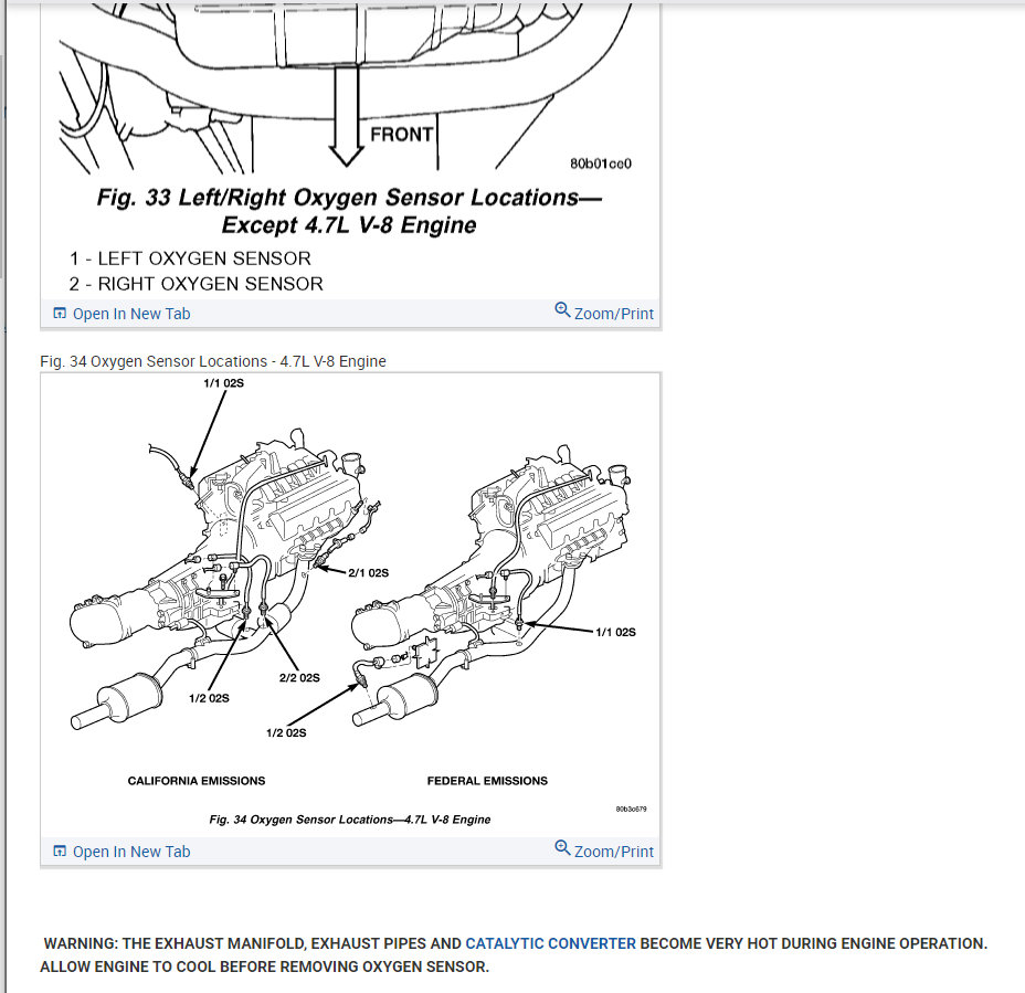

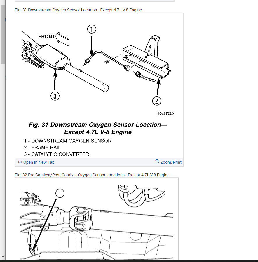

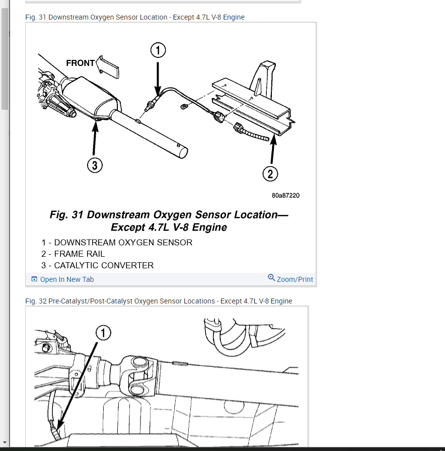

I am replacing o2 sensors. I need to know the sensor locations please?

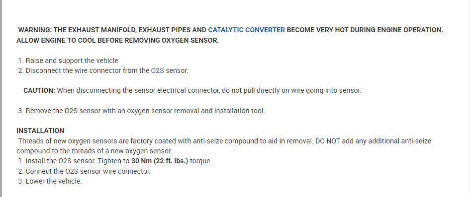

Here are a couple of guides that will help with replacing the o2 sensors:
https://www.2carpros.com/articles/how-to-replace-an-oxygen-sensor
https://youtu.be/B4CAou7i7Io
Below you will find the process from the manual that will help with replacing these sensors. Please run through this material and let us if you have other questions. Thanks
