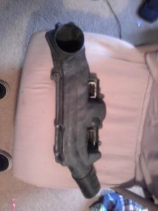

MCNAIR8281
  • 7 POSTS
I have checked all the wiring running from the alternator to their respective sources, and all the wiring is conducting, so i have come to the conclusion that it is one of the two computers the vehicle is utilizing for the feild charge one is the Logic module and the other is the Power Module. My question now is, which one would be more likely to fail? They are both roughly the same price, in the neighborhood of 100-130 dollars, but I don't want to have to replace them both if I don't have to... I'm thinking it's the Power Module, seeing how the air induction runs through it, but I'm not sure. Any suggestions? included is a photo of the Power Module I already removed

MASTERTECHTIM
  • CAR REPAIR CONTRIBUTOR
  • 4,750 POSTS
that would be my educated guess too, considering if air is going through then so is moisture. i have never seen this system before.

MCNAIR8281
  • 7 POSTS
That was my assesment as well. There is probably a reason they don't use this system anymore...However, I checked the recall lists for this year make and model, but there was no recalls on this particular problem. It seems pretty stupid to have the air intake going through a main CPU, if you ask me, it would have been easier, (and smarter) to just have the sensor for the air intake in a separate unit.
Could you find out the OEM part number for my power module? the VIN is: 1B3BA64E1GG142424
Somebody peeled the sticker off that had the number on it, and I'm going to need it to order the correct part --thanx
