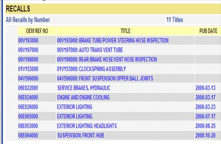

Hey by the way. . .. . .. . ..I did search through about 120 TSBs and didn't see anything related to your problem. . .. . .. . .. . .
Now I have attached some recalls I think you should check on once you get this figured out. The dealer may fix these for free. Please contact the dealer service department, give them the VIN number of your car and have them check on these to see if they apply to you.
