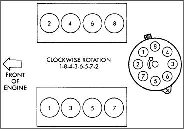

1998 Dodge Dakota V8 Four Wheel Drive Automatic
I have a spark plug wire crossed.
I know my engine's firing order. 1-8-4-3-6-5-7-2, but I can't see the #'s on the cap to see if spark plug 1 is on #1 on the cap.
Is there a diagram with #'s for the cap so i can corospond the wire's from the plug's too?

Hello, this is what I found. I don't trust pictures.
https://images.2carpros.com/forum/automotive_pictures/170934_dodge_dakota_1.jpg

I believe this might help me.
Do you know if the cap order is correct?
From the pic it looks like #2 is facing the front of the engine?

Hey it worked. This is exactly what I needed and my truck is running great now.
Wires 5 and 7 we're crossed
