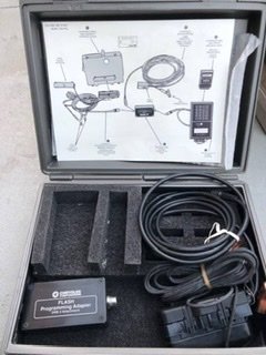

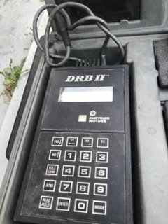

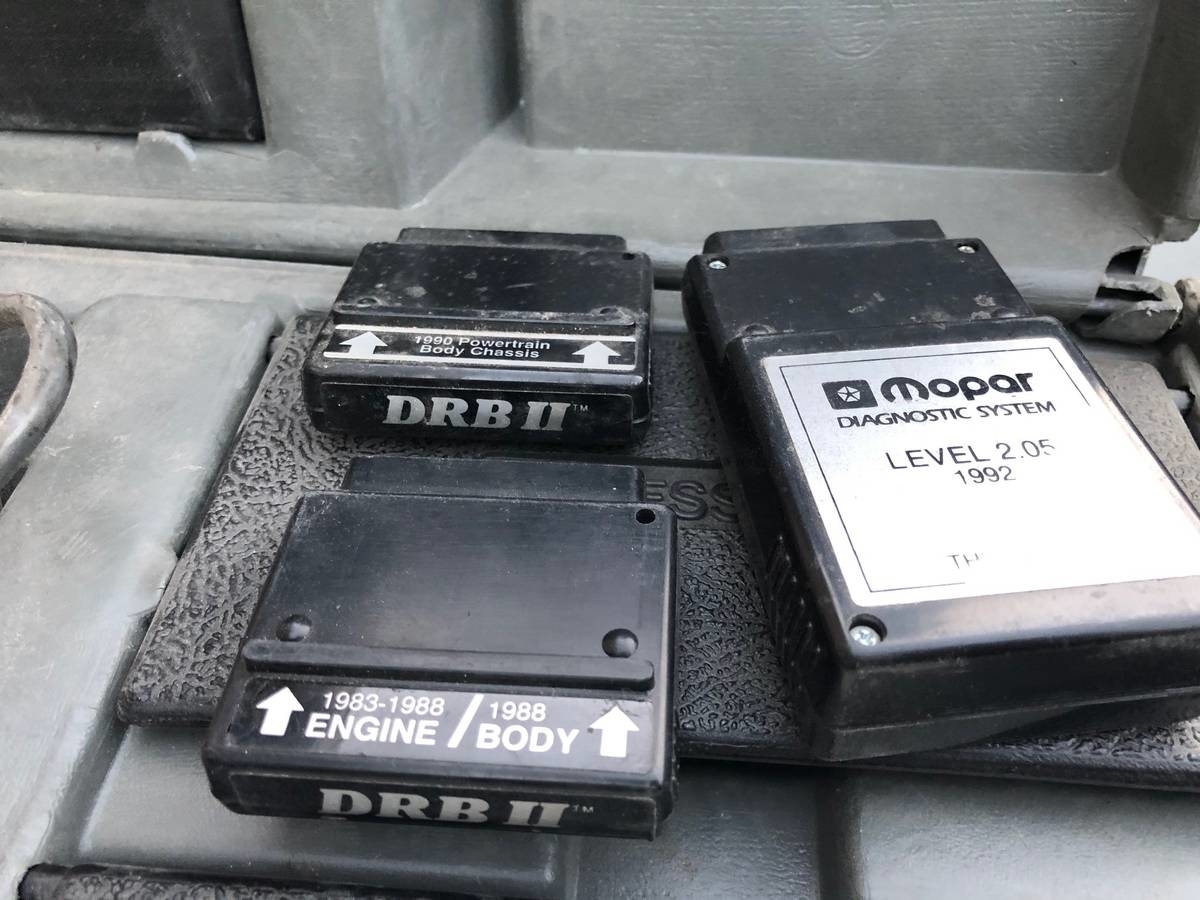

Hi Joe,
just found these for sale $180.00.
Factory MOPAR dealer tools;
10105- Engine tool DRB II (good for vehicles up to 1992, not anything 2000 or newer)
(comes with multiple cartridges 1992 and older)
CH5500- Flash programming tool (has to be purchased with 10105)
CH8432- supplemental reprogramming tool.
I have a 1991 and 1993 Dakota, both 2WD 5.2V8’s, one standard cab, other club cab.
So, is this the “Magic Box”, what I need to “make it right-clear the light”, plus it will clear “Check Engine Light” issues too?
Is there a way we can take by phone? Somehow “private message”?
Thanks.

Went to the Dodge dealer today and on the way there, the “check engine” light came on too they cleared them both.
They said their DRB device was on its last leg/worn out.
So I bought the pictured equipment I found for $80.00.
Friday, August 28th, 2020 AT 9:24 AM (Merged)
  • 110,192 POSTS
Wow, if it is in good condition, you got a deal. I just hope you never have to use them because that would just mean more problems. LOL
