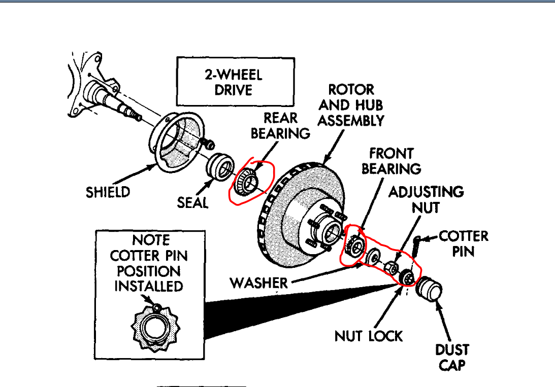

I am having an issue with my 94 dodge dakota 2wd 3.9L, the bearing in my front left went out so i got a whole hub assembly. But when i took the old one off i cant get the new one to stay in place. What keeps the hub assembly in place???
Jan 19, 2020 at 5:57 AM
  • CAR REPAIR CONTRIBUTOR
  • 110,193 POSTS
When you say hub assembly, are you referring to the brake rotor? On a 2 wheel drive, you have an inner and outer wheel bearing which goes over the spindle and then is bolted on. Take a look at the attached pic and let me know exactly what part you are referring to.
