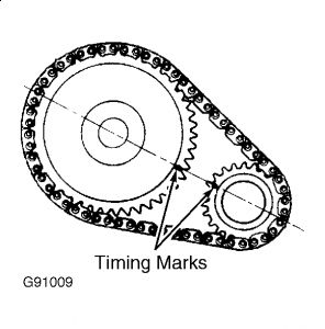

Found out that the timing chain had broken one of the sprokets replaced it but now cant get it in time

https://www.2carpros.com/forum/automotive_pictures/99387_Graphic1_261.jpg

Yeah I have that but how do you know if its right because I know there is 2 cycles to each one can anyone help

What do you mean
set the timing as you see it in the pic
