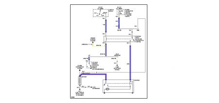

my dakota wont start, I turn the key and nothing happens, done replaced the started and the ignition switch, still nothing, any idea what it could be.

Test the battery and connections if okay. Check fuse B 30amp, starter relay, A/T park and neutral position switch and starter itself
