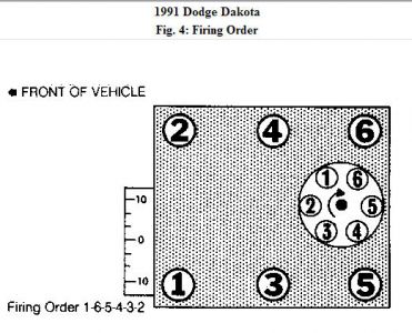

Engine Performance problem
1991 Dodge Dakota 6 cyl Two Wheel Drive Automatic
I need instructions from the wires to the distributor cap. I accidently knocked some off tryiing to replace the dist. Cap and now they are out of sequence an the truck is skipping
Tuesday, August 5th, 2008 AT 9:45 PM
OBXAUTOMEDIC
  • 3,711 POSTS
Here ya go....
https://www.2carpros.com/forum/automotive_pictures/188069_91dakotafiringorder_1.jpg
