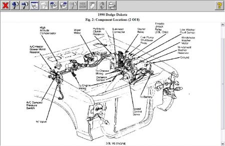

Vech used to be off and on, some times starts sometimes not. Now she cranks fine but just won't start
Tuesday, December 25th, 2007 AT 8:35 PM
MECHANIC
75,992 POSTS
Is this a 3.9L engine
Look for the magic relay called the ASD relay-this relay power the coil/injector/s and fuel pump. Test it out
See below for the fuel pump shutdown relay
