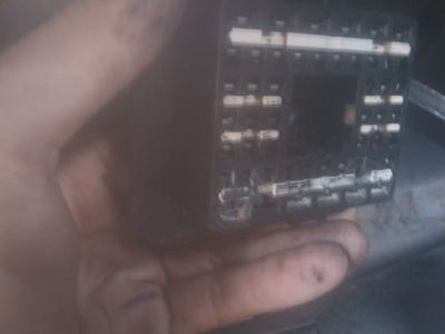

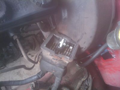

So, tinkering around with the wiring, i found this. The geniuses at autozone cant tell me anything about it. it needs to be replaced. but i dont know how to go about getting a new one. im not sure if its relevant to the headlight problem.. but it definitely needs to be replaced. its hard to tell by looking at the pictures. but corrosion has eaten through some of the connectors.

also. i dont know which fuse circuit im having a problem with. i dont know anything about wiring.. im just kinda trying to teach myself as i go..

Is that where the electricals go through the firewall? That maybe a dealership only item? On an older vehicle, if it is a dealer only item, it may be out of production. Sometimes I have to find a part at the salvage yard, on older vehicles.

Yes, and the wires that come from the headlights lead here. Although they're not the bad ones. But it goes through the firewall. The second picture is near the pedals.I

Thru the firewall plug advice was just the ticket for no headlights tail and brake. Lower left RED hot wire blade was corodide off. Remove battery cables and just cut wire on hot side drill 1/4" hole above plug splice new wire in and put thru hole. Cut same wire on inside and splice together. Headlights once again.
