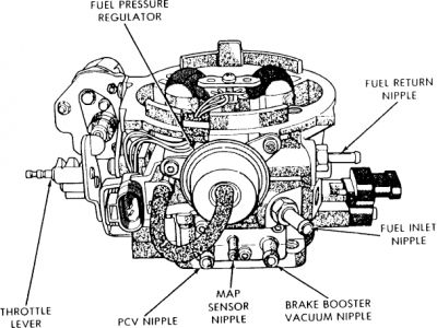

Where would the fuel pressure regulator be located at and what should the pressure be at?
Thursday, September 9th, 2010 AT 8:52 AM
WRENCHTECH
MECHANIC
20,761 POSTS
The fuel pressure is 14.5 at idle. Check out the diagrams (Below). Please let us know if you need anything else to get the problem fixed
