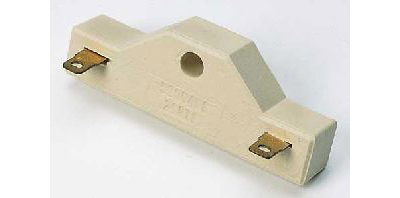

Also I am not sure with that year but there may be what is called a Ballast Resistor, it is usually located on the firewall somewhere and it is Ceramic. Here are a few pics of different ones.
https://www.2carpros.com/forum/automotive_pictures/188069_BallastResistor2prong_1.jpg
https://www.2carpros.com/forum/automotive_pictures/188069_BallastResistor4prong_1.gif

My husband says the only Ballas Resistor is on top of the engine next to choke thermostat. Would that have something to do with it?
Monday, March 30th, 2009 AT 6:05 PM
OBXAUTOMEDIC
  • 3,711 POSTS
Does it look similar to one of the pics I posted. If so it could be your problem.
If it looks like the 2 prong restistor have him jump the terminal and see if it will start.
If not sure about the resistor, if you can take a pic and post it.
