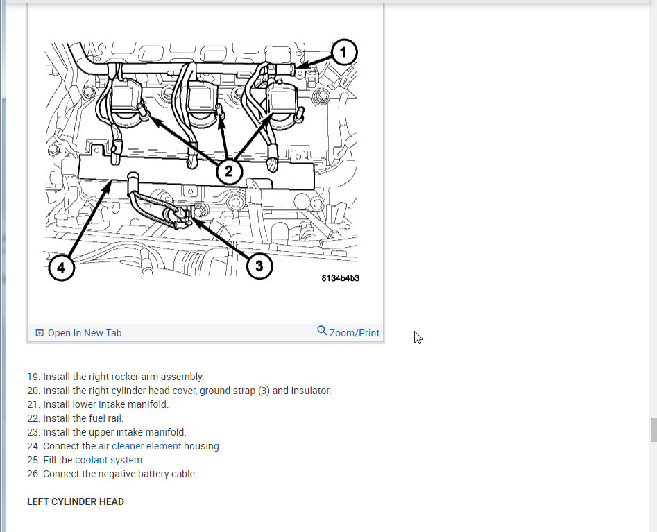

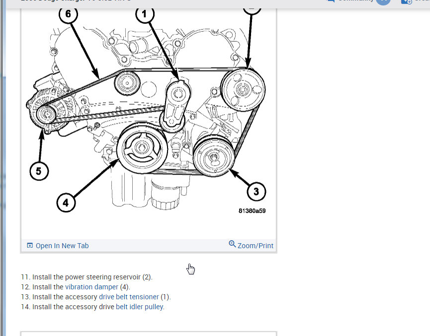

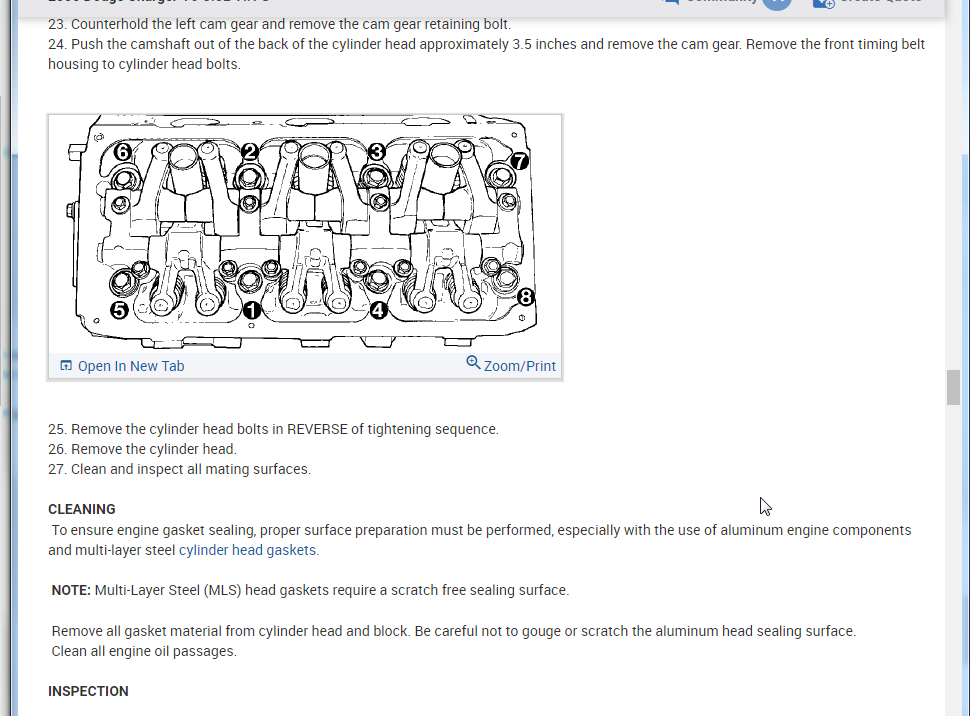

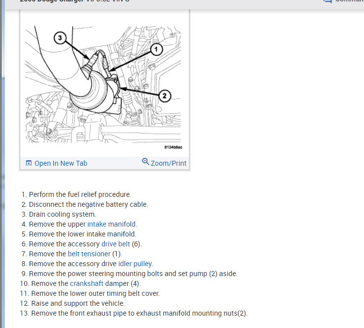

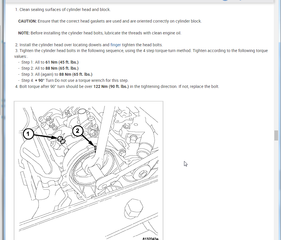

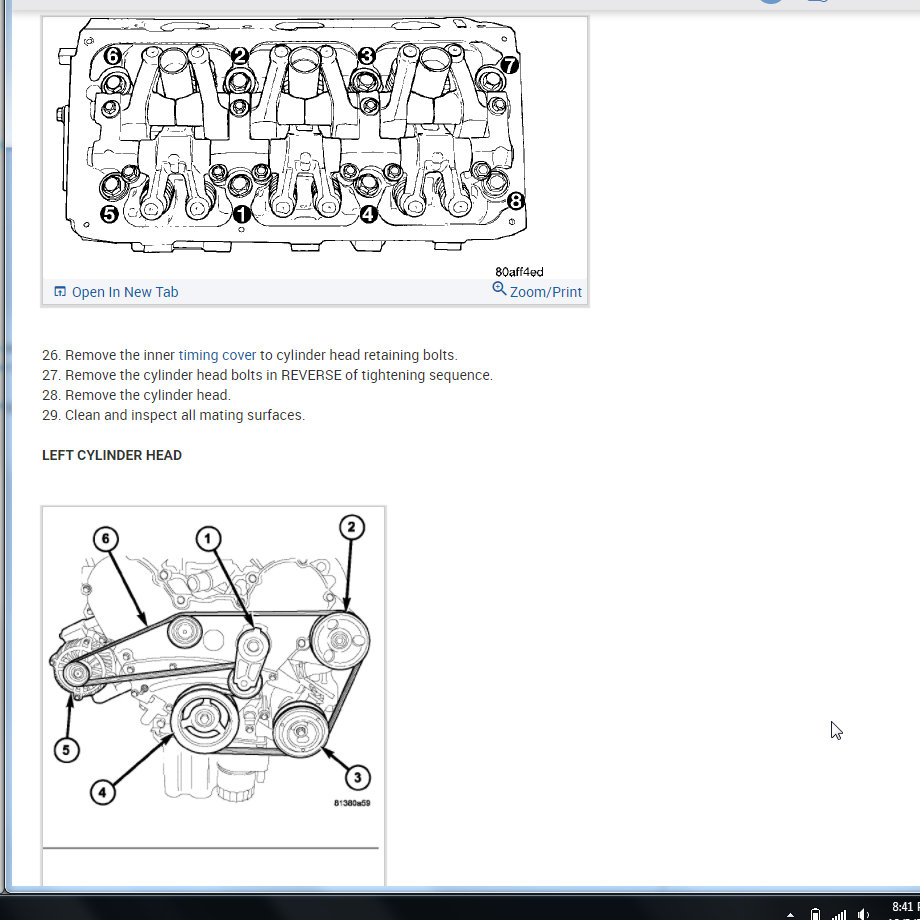

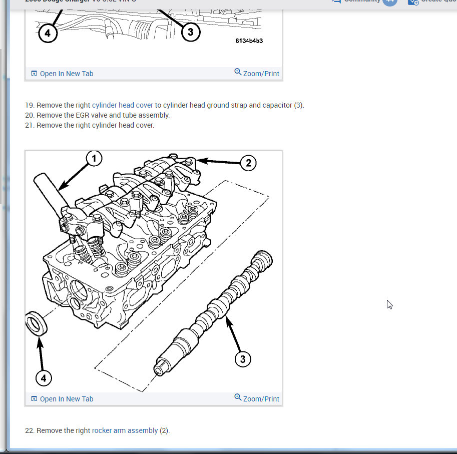

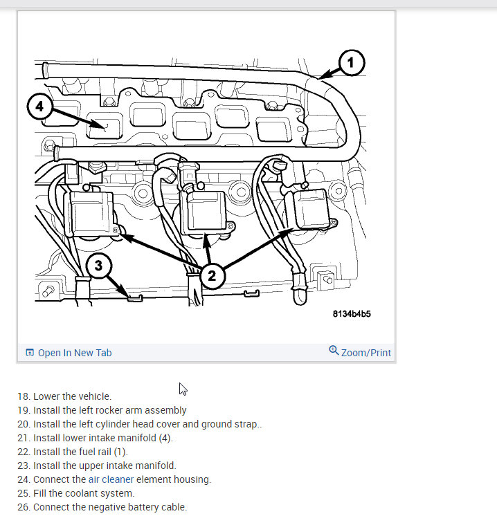

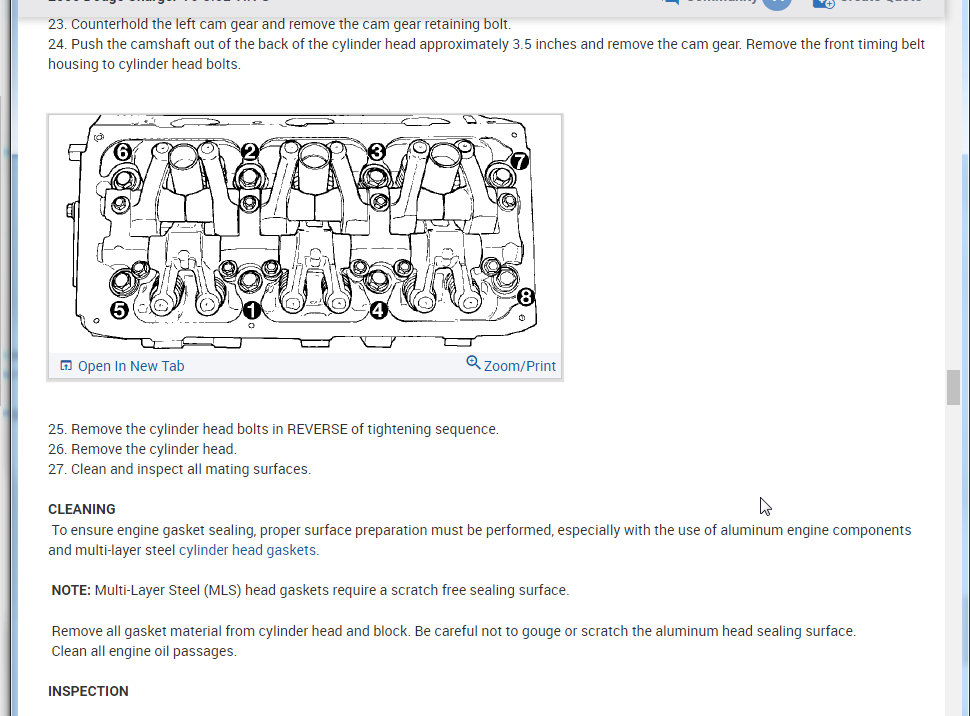

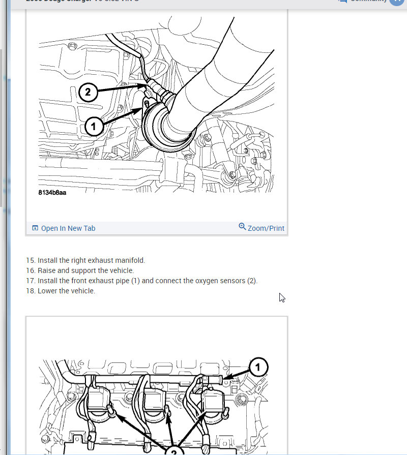

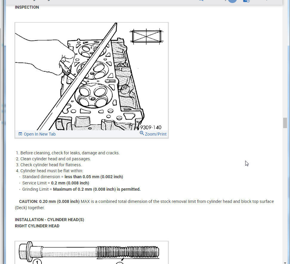

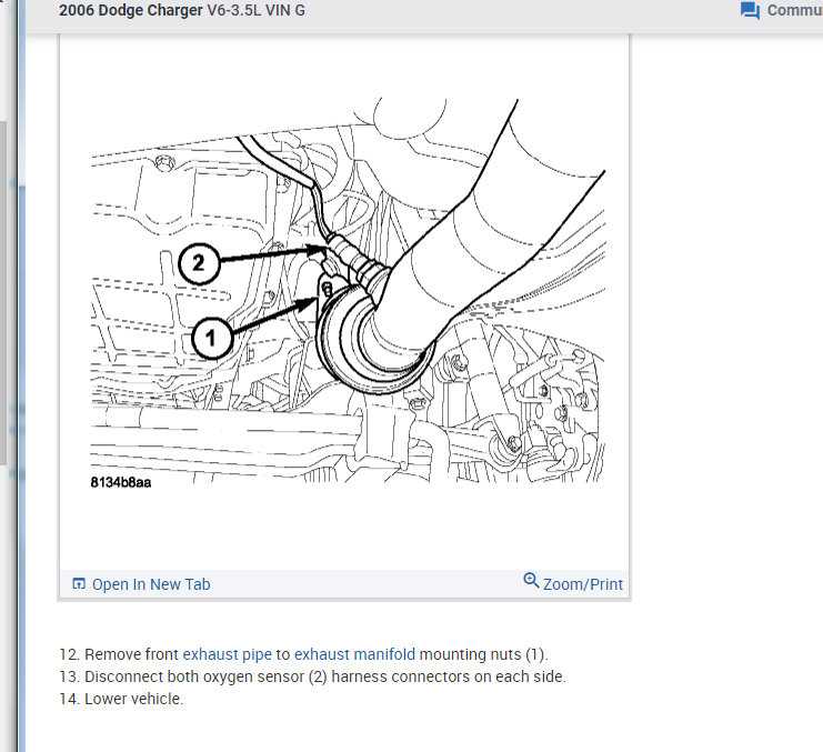

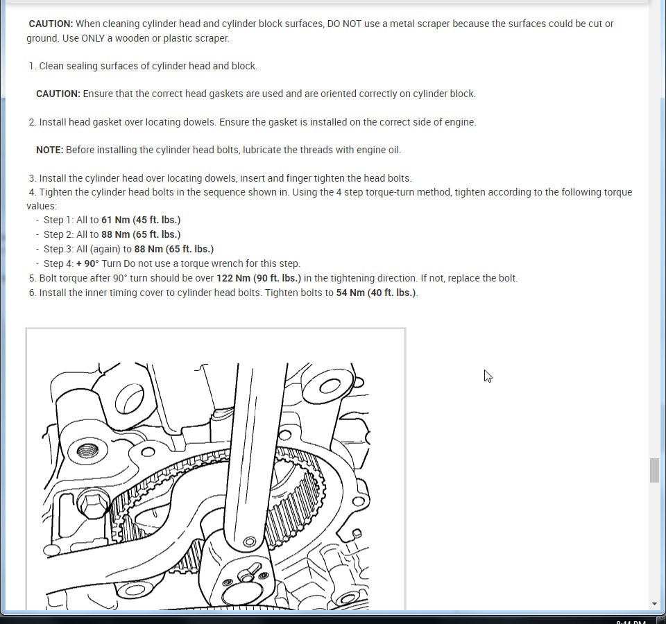

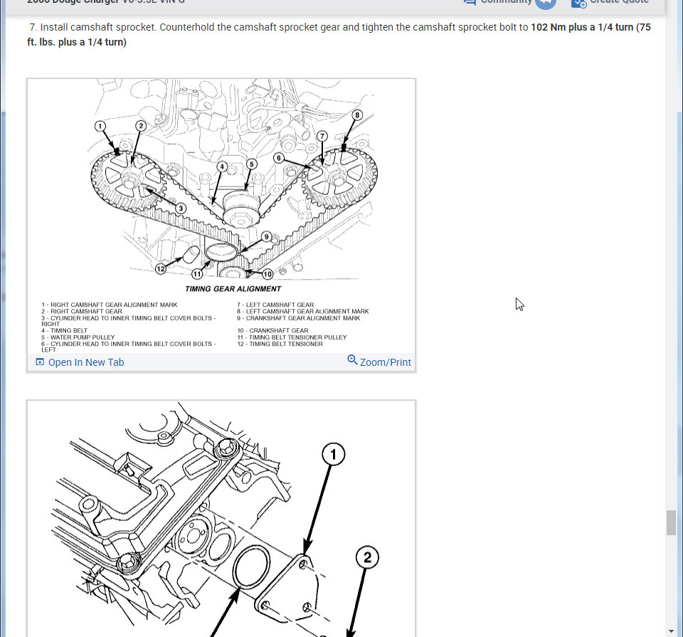

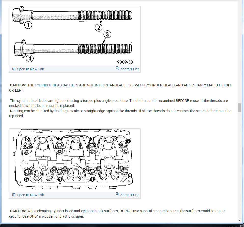

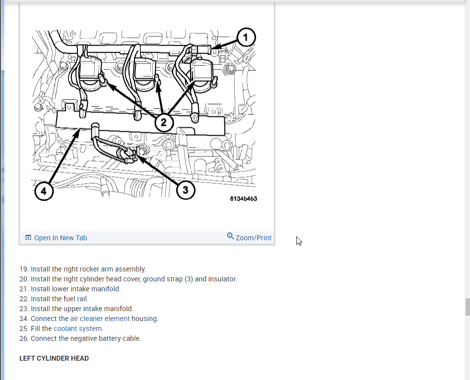

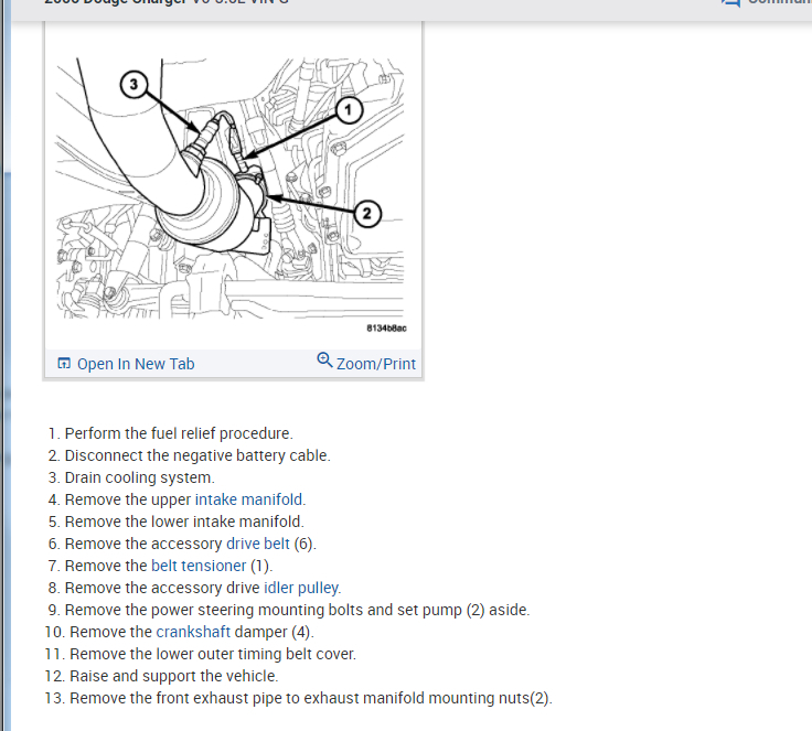

How much would you estimate a replacement of a head gasket to be around?? Can I do it myself can you show me please? 3.5L engine.
Jul 16, 2010 at 10:37 PM
  • CAR REPAIR CONTRIBUTOR

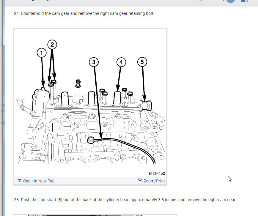

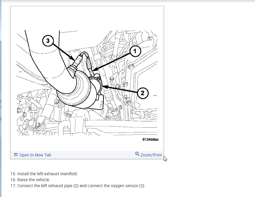

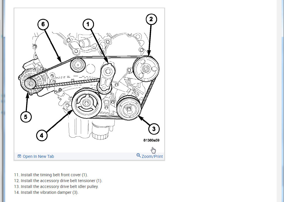

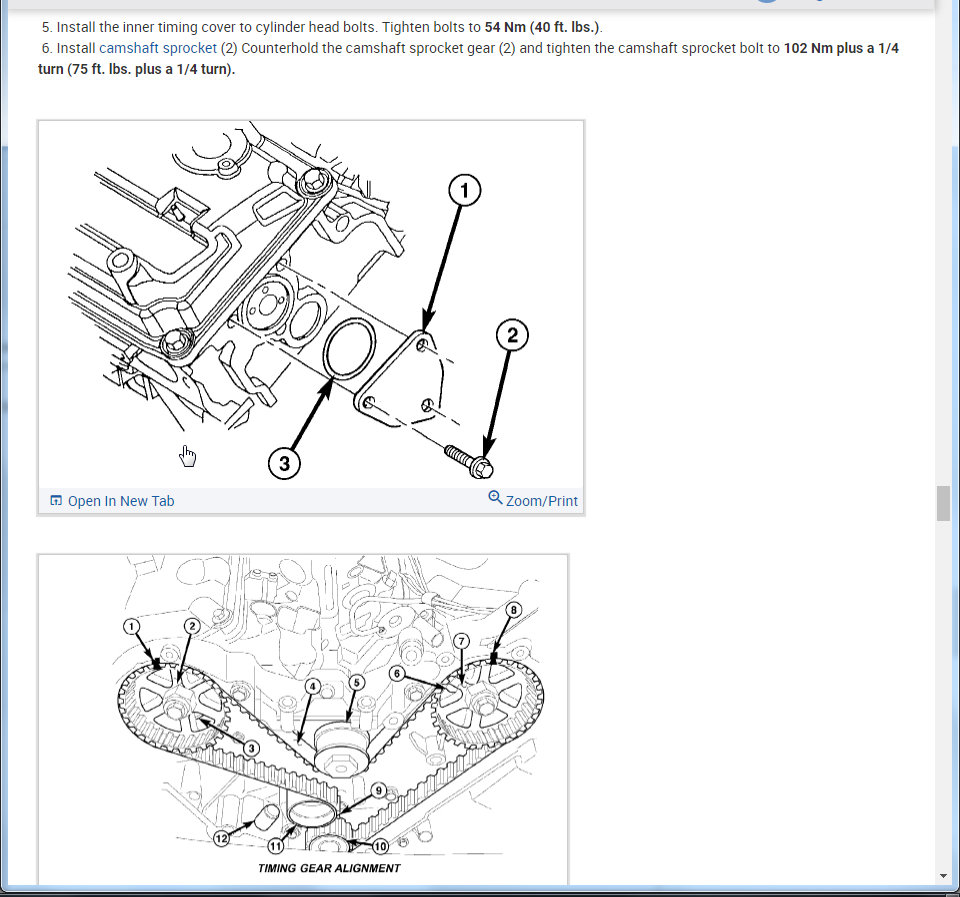

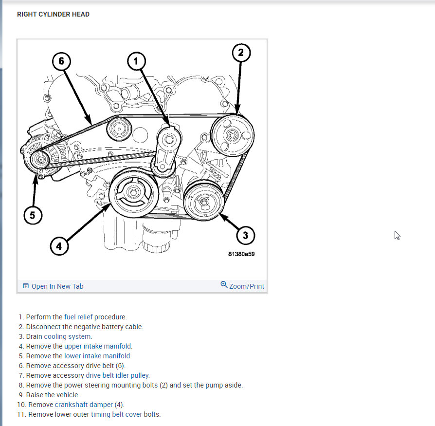

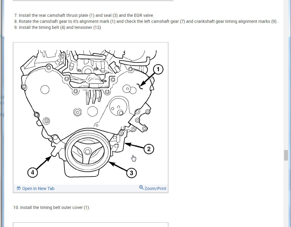

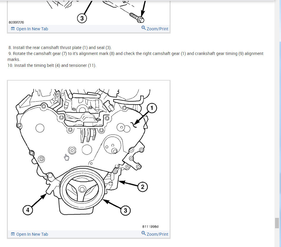

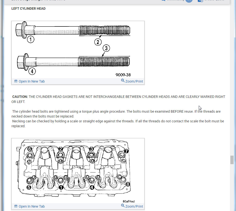

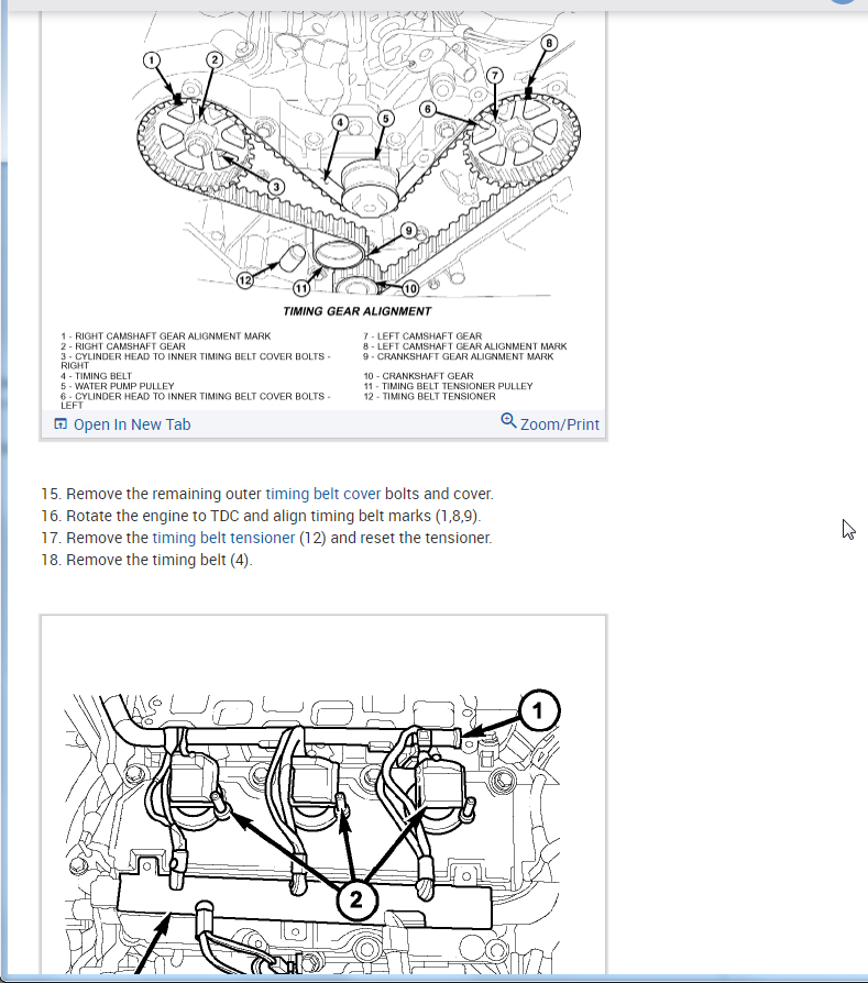

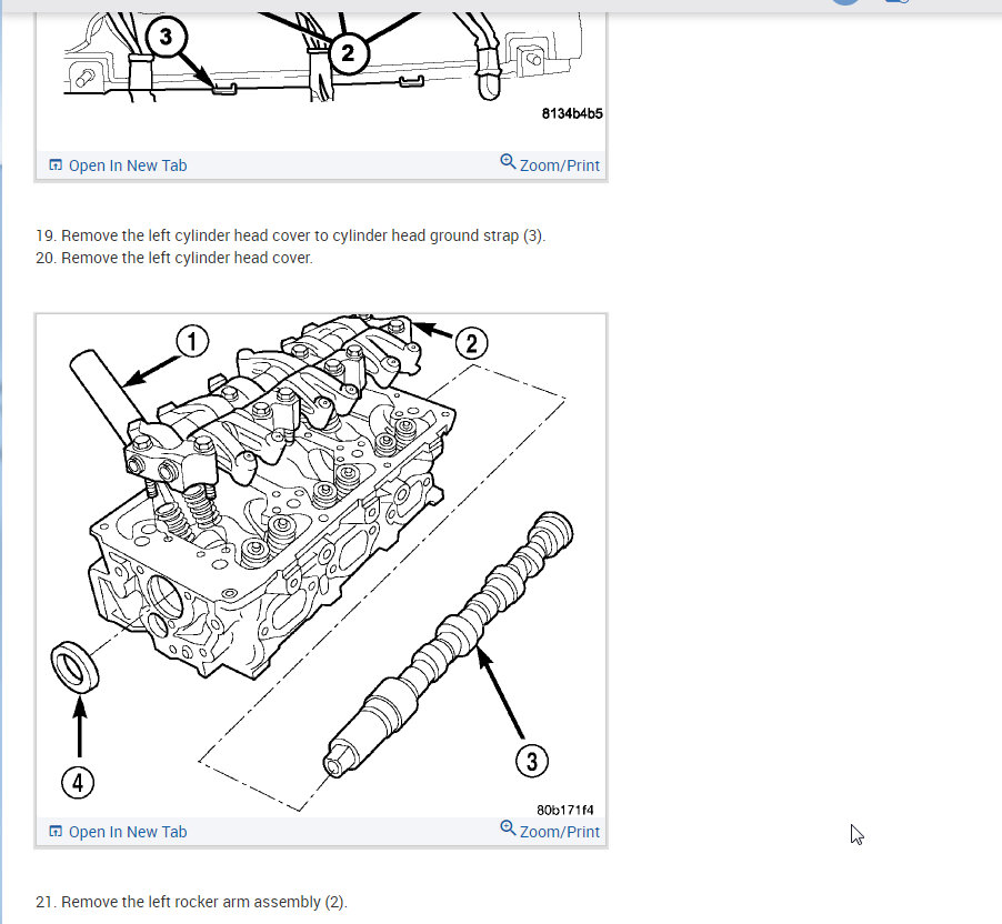

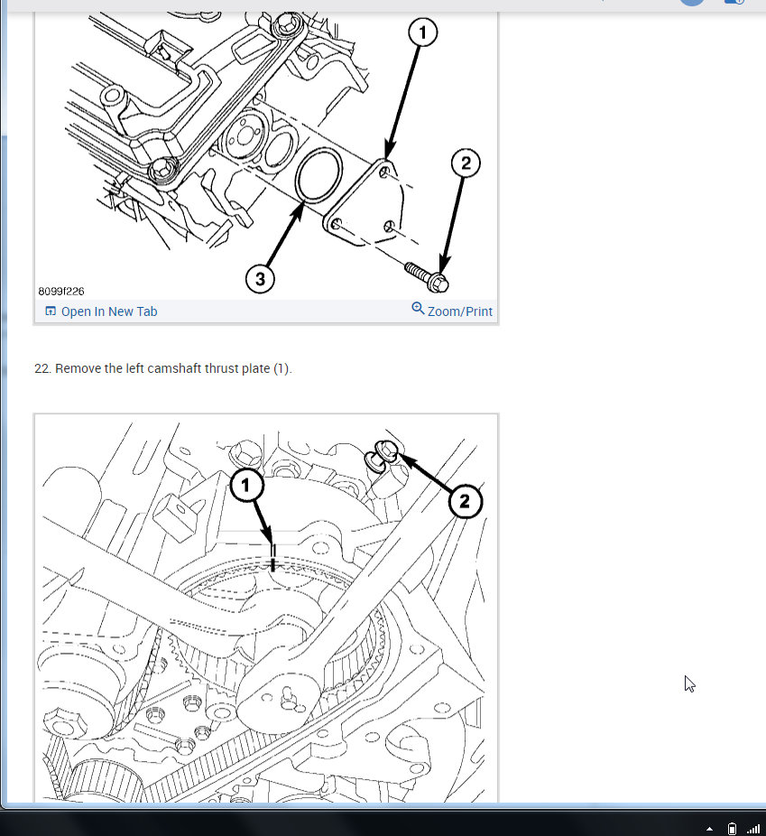

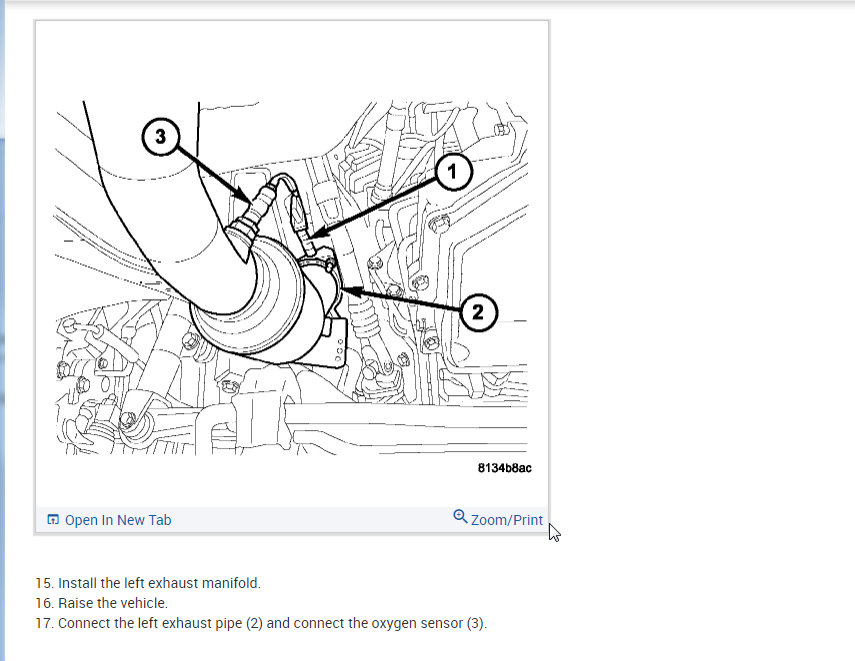

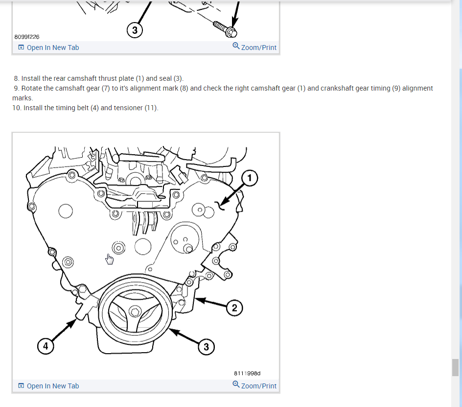

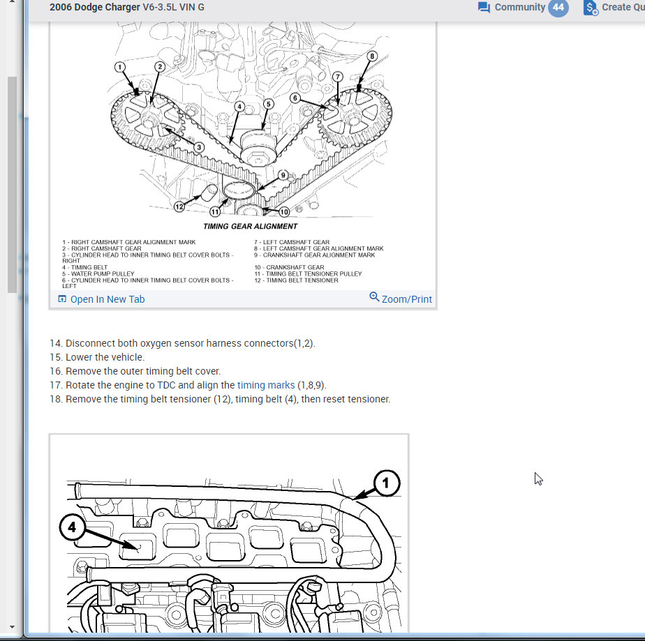

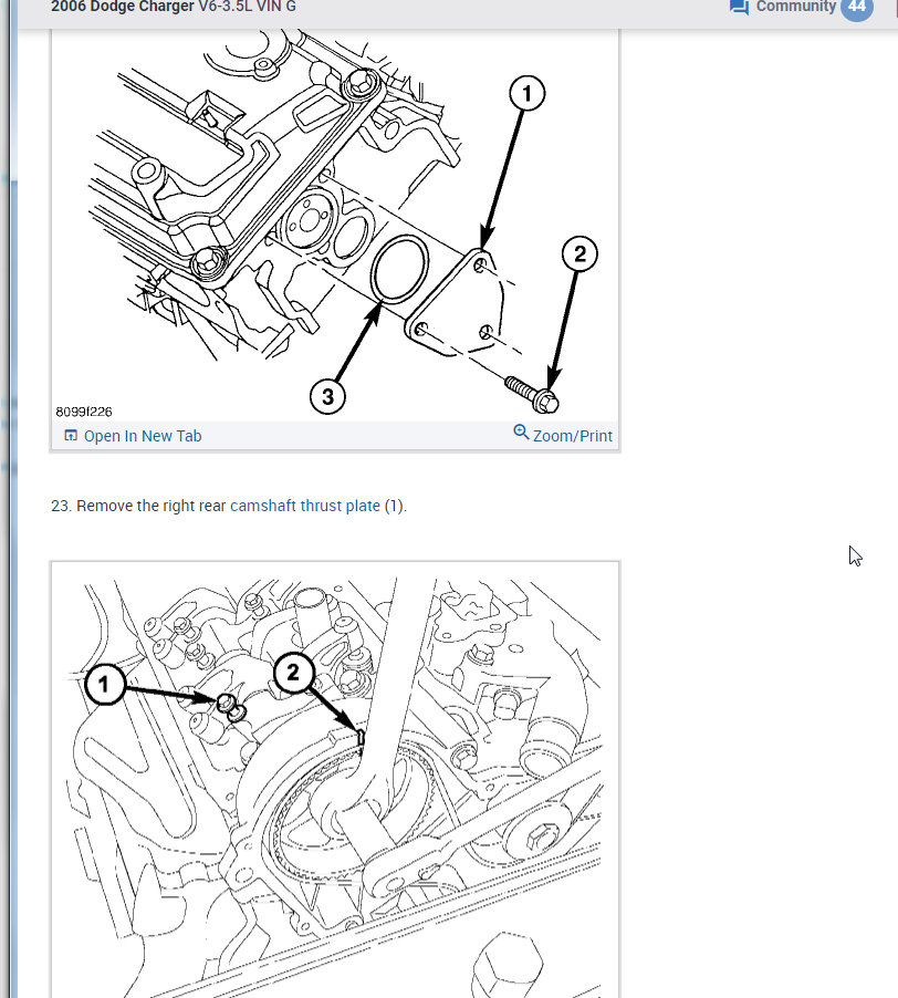

I am attaching the entire process on how to replace these so you can review it to see if you want to attempt it. The parts are going to be around $100.00 for the gaskets and other parts. Then the labor is 8 hours per side or 12 hours if you do both at the same time. This means you multiple these hours by the shops door rate and that will give you the labor. So in most cases it is from about $1,000.00 to $1,400.00 to have one or both sides done.
Let us know if you have other questions. Thanks
