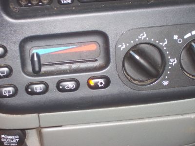

Recently, I noticed my A/C is staying on all the time even when it is supposed to be off. I know this because I can hear the clutch clicking on and off to charge the system. The air is cooler than normal when the A/C is off. I have also noticed water condensation puddles under the car in the garage after coming home on cool days when the A/C was not turned on. This doesn't happen when the A/C is not being used.
So, if the A/C clutch is the problem, can that be replaced separately or do you have to replace the whole compressor?

I have a 1998 caravan and I have to push a button in for the A/C to come on and a yellow lights up to tell me it is on. Sounds like a switch problem? You are pushing the switch all the way in ? does the light go out on the switch?
Start it up and look under the hood at the A/C compressor if the pulley and the clutch on the end of it are all turning the A/C is on. Go inside and push the switch in and come back out and see if the clutch / very end of compressor stopped turning. If it stopped the A/C is off if not the switch is not telling it to cut off.I have never installed one but it looks like it is just a push button switch.But it may be all made together to make you buy the hole switch assy.
I had to have the whole control panel replaced on mine, thank god for extended warr. it paid for the whole thing I think it would of been 200 bucks parts and labor at the dealer. Hope this helps you good luck
https://www.2carpros.com/forum/automotive_pictures/88700_A___C_Switch_1_3.jpg" alt="https://www.2carpros.com/forum/automotive_pictures/88700_A__[img]https://www.2carpros.com/forum/automotive_pictures/88700_A___C_Switch_1_3.jpg" />

Thanks Greasemonkey! I did confirm yesterday under the hood that the A/C compressor clutch is cycling on and off with the A/C switch off as I thought. The switch seems to work since the light comes on and goes off accordingly and when the compressor clutch disengaged, I had a helper turn on the A/C button from the dash and the compressor clutch immediately engaged. However, it won't shut off when the A/C button is off.
What do you think now?

I Just thought of something. Looking at the picture I posted off my control panel. The one you turn to make the air come out the dash vents, floor or defrost. If you have the switch in any of the last two settings "defrost"modes that by-passes the push in button switch. Because any time it is in defrost mode the A/C compressor is engaged. Remember the old cars pre-1980 when you turned on the defrost the windshield fogged up that was because it had moisture from the heater in it. Todays cars kick the A/C on because they want to to mix the warm air with the A/C air to make dry air to clear the window quicker.
So make SURE the vent switch is on the dash vents or floor vent and not any one of the defroster modes.
Try that and let me know

Thanks again grease monkey. Good thinking but unfortunately that is not the problem.

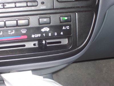

Question for ya Greasemonkey, when you turn your air direction control to windshield does the A/C compressor come on? AND, does the A/C light come on? My A/C light doesn't come on when I move the air direction control knob. However, in my Honda Accord, when I select the windshield, the A/C automatically comes on and it blows cold air.

Great question, I had to go fire up my van and see. Yes the A/C does come on when I turn the vent control switch to any of the defrost modes. But the light does not come on. I have a noisy A/C clutch so I know when it kick on. Thanks for the question

I have a 1996 Honda Civic and it does what you said the little green light comes on to tell you the A/C is on when I push the defroster button in. I have to say Honda thinks about stuff like that and designs it in to the car.
I hope I have helped in some way ,If so please leave feed back
https://www.2carpros.com/forum/automotive_pictures/88700_Honda_A_C1_1.jpg
