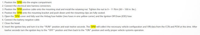

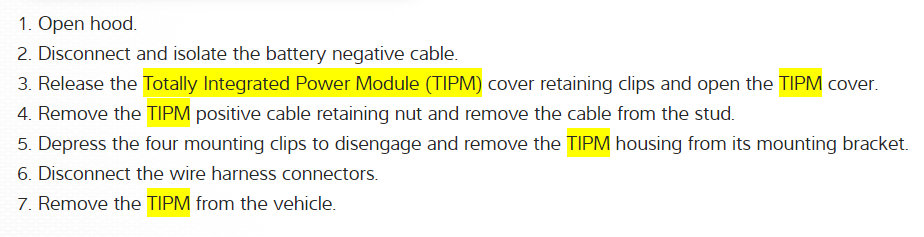

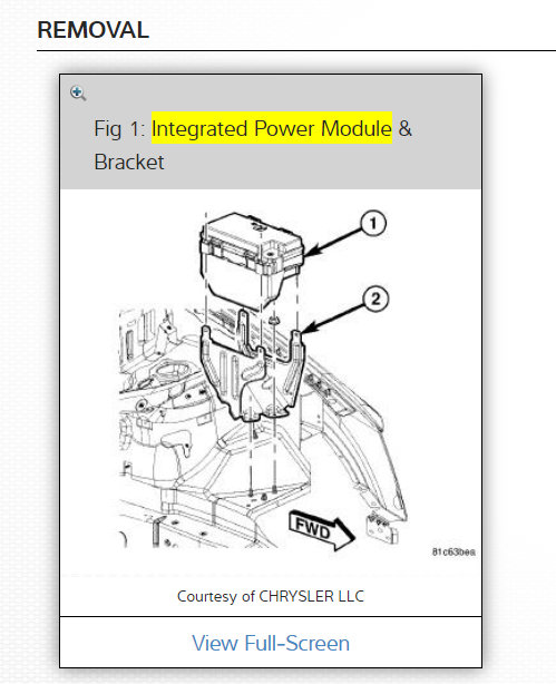

This is a common problem when the TIPM goes out which is common but you are in luck because it is easy to replace because it self initializes. Here are the instruction in the diagrams below to show you how. Check out the diagrams (Below). Please let us know what happens.

Thank you for this post I had this problem and had to replace the TIPM cost me $234.00 all fixed I love this site.
