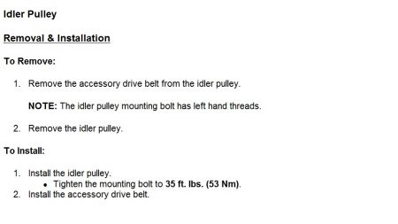

how do you remove the Idler pulley of the 3.3 engine
Jul 10, 2010 at 11:24 AM
INTERNETMECHANIC
CAR REPAIR CONTRIBUTOR
700 POSTS
Thanks for donation. I didn't see a picture, found the info below.
