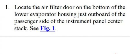

Cabin air filter needs to be change where is it located. Does my van have one. How do I get to it.

Hi there,
See pic for location & access for cabin filter.

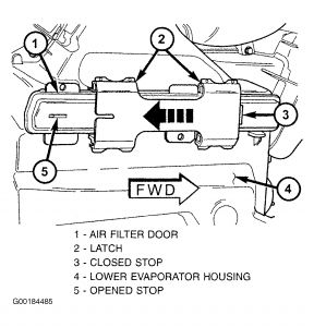

Where is evaporator housing located. Under hood or behind glove box?

Info for location.
