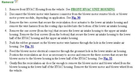

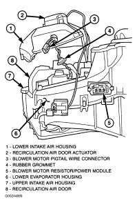

My blower died. I have changed the fuse and selinoid but no help. A mechanic wants to charge 450.00 plus cost of motor because "the dash needs to come out to get to it"...Is this true if so can someone give me or refer me to instructions on how to do so? I have the replacment motor and am capable...Please help.
