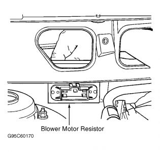

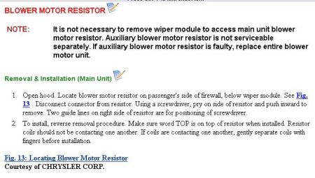

How do I change out the resistor pad?
Tuesday, January 20th, 2009 AT 5:43 PM
ZACKMAN
  • 4,202 POSTS
https://www.2carpros.com/forum/automotive_pictures/55316_05caravanresistor_1.jpg
https://www.2carpros.com/forum/automotive_pictures/55316_05caravanresistor_2.jpg
Figure 13
