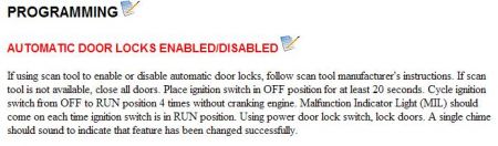

My caravan doors lock automatically everytime I go over 5 miles per hour. Is there any way to turn off this feature?2.00

The procedures for turning this feature off are as follows:
