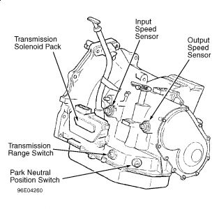

Why does my 2000 dodge caravan stay in one gear
Tuesday, December 8th, 2009 AT 6:46 PM
BMRFIXIT
MECHANIC
19,053 POSTS
Check for tranny codes
suspect speed sensor and if so replace both you have input and output sensor
also tranny solenoid pack is another possibility
need to have it checked for code s
