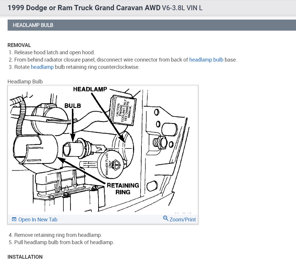

How do you replace the headlight bulbs?

Welcome to the forum. I found the info below at autozone, don't know if it will work Check out the diagrams (Below). Please let us know if you need anything else to get the problem fixed.
Image (Click to make bigger)
