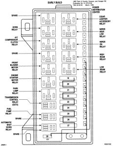

I have two lighter outlets in my 99 Dodge Caravan and both are not working, just suddenly stopped working. Is there any way to get this working again?

Hi Athmysts, Welcome to 2carpros and TY for the donation
Check and test the lighter relay in the power distribution center
Check fuse #8 in Power Distribution Center underhood
Let me know
