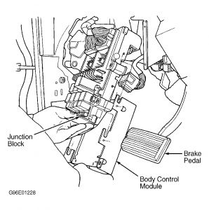

I've had problems where the headlights and interior dash lights would flash on and off both with the engine running and when it is shut off. Also the wipers would stop working in the intermittent setting and would run on at times after they were shut off. Now I can't start the vehicle, and when I try, the relay in the PDC clicks repeatedly until you disconnect the battery. My mechanic says it's the bcm, and that chrysler has to code it before it can be installed. Seeing as money is tight, I'd like to do this as cheaply as possible. Could it be a bad ground? And if not, is the bcm something I can pick up at a junk yard and put in without coding. Or could I get one from the junk yard and have it recoded?
Sep 20, 2008 at 1:21 PM
BMRFIXIT
  • 19,053 POSTS
This is the procedure to replace the BODY CONTROL MODULE (BCM) in case all tested OK and u need to replace it Removal 1.Disconnect negative battery cable. Remove lower steering column cover and knee blocker reinforcement. Disconnect harness connectors from BCM. The BCM is located behind junction block. Remove bolts securing junction block to dash panel mounting bracket. 2.Remove junction block. Remove screws securing BCM to junction block. Slide BCM downward to disengage guide studs on junction block from channels on BCM mounting bracket. Remove BCM from junction block. To install, reverse removal procedure. check all fuses try and locate the BCM and disconnect it for a few minutes and then reconnect remove relay that clicking and test its connector turn key on you should have power on at least one try to start 2nd wire should power up one should be grounded

BMRFIXIT
  • 19,053 POSTS
Removal

  • 1,320 POSTS
On each side of the instrument panel are the two ground locations the BCM uses both. You'll have to open each door remove a trim panel and look up each side on the body. It's two 10mm screws and they have multiple ground straps you may remove and clean up. Every component is so ground oriented I wanted to start doing this as part of a 60,000 mile service. A ground service. But since people might think they were at an airport, I just do those and the engine compartment spots. OK good luck. A 24 volt system would eliminate all these problems. But what do I know. thanks
