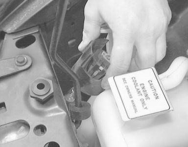

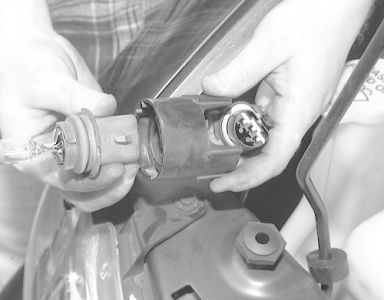

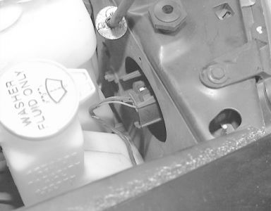

How can I replace Passenger side Headlight? It seems the main bulb is burnt out.
Sunday, December 30th, 2007 AT 1:32 PM
FAIRRACING31
MECHANIC
150 POSTS
The headlight bulbs can be accessed from the engine compartment behind each headlight.
Rotate the bulb socket retaining ring counterclock wise and remove the ring. Pull bulb out of socket and replace.
Twist bulb counter clock wise......
......and unplug the electrical connector.
Dont touch the glass when installing the new bulb
Have a Great New Year's :D
