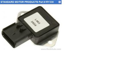

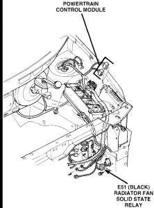

Can you tell me where to find the cooling fan relay. Is it behind the block under the dash?

The location is in the diagram, not sure how easy to get at? You can see the wiring colors for the connector. Under the hood, driver side front.
https://www.2carpros.com/forum/automotive_pictures/170934_caravan__fan_relay_1.jpg
Wrenchtech is right about the relay appearance.
https://www.2carpros.com/forum/automotive_pictures/170934_98_caravan_relay_picture_1.jpg

This relay looks different than most relays because it is a solid state relay and it is hidden very well. It's mounted to the inside of the frame rail on the driver's side, near the radiator.
https://www.2carpros.com/forum/automotive_pictures/561653_cooling_fan_relay_loc_98_T_and_C_1.jpg
https://www.2carpros.com/forum/automotive_pictures/561653_cooling_fan_relay__98_T_and_C_1.jpg

Thank you for your help this was very helpful, found the relay where your diagram said it should be, if any one want's to know the price from the dealer is approx.$114.00 plus tax in canada.
