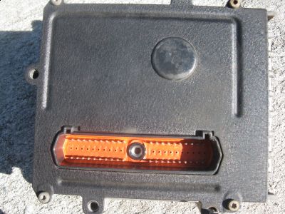

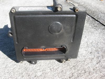

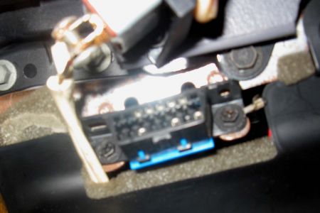

Have attached a picture of what I think is the CAB off the right side of the engine bay. Please confirm.
My check of the alternator output at 2000 RPM is 15.45 volts and does not go above that.
However, the DTS plug in my Caravan does not look like your diagram. It only has 16 pin bays and of the 16, only 8 are used.
Correction, the alternator voltage is 14.45 volts, not 15.45.

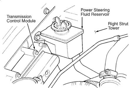

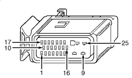

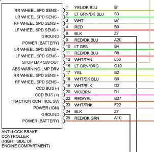

I think you found the TCM, Transmission control module... Cab is on the right side too!
http://www.2carpros.com/forum/automotive_pictures/62217_TCM_4.jpg
http://www.2carpros.com/forum/automotive_pictures/62217_cab1_1.jpg
When you find it match up the wires to this...
