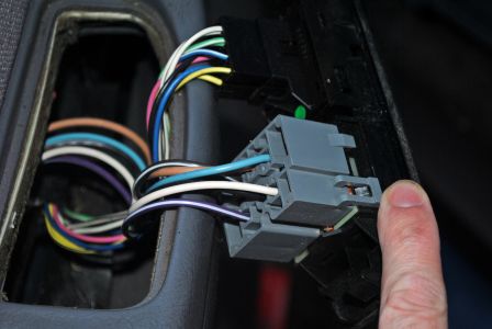

I have a 1993 Dodge Grand Caravan mileage 100,000. The driver side power window isn’t working . The passenger side works fine. Anyone have the answerer. any information will be greatly appreciated. thank you
There is no sound when i push the driver side button. The passanger side control does not work either. I removed the switch and the wires to the passenger side are hot but the wires to the driver side are not. In the picture the wires in to the driver side control without power are the white and blue ones.

Hi Hink424. Welcome to the forum. Do you hear the motor run? If so, the flexible plastic track is broken. I think you can get them at the car parts places now for less than ten bucks. If there's no sound, and if the passenger window only works from the passenger switch, pull the rubber boot back between the door hinges and look for frayed or broken wires first. If you find some, I'll copy and paste my fix.

Caradiodoc, Thank you for the welcome and the response! There is no sound when I push the driver side button. The passanger side control does not work either. I removed the switch and the wires to the passenger side are hot but the wires to the driver side are not. In the pictureI added, the wires in to the driver side control without power are the white and blue ones. Wish I new where the wires come from.

Did you pull the boot back to look for broken wires?
