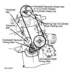

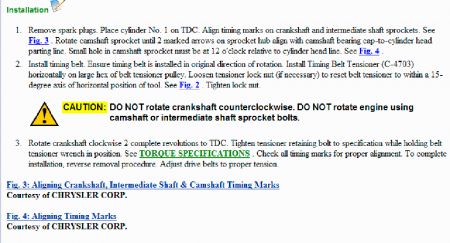

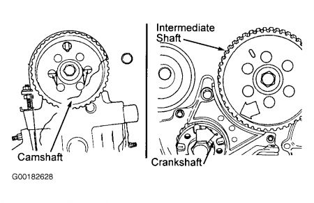

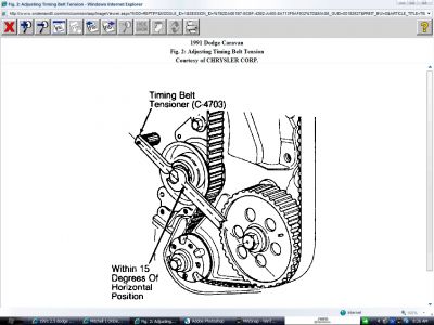

Ihave a 1991 dodge caravan 2.5 and timming belt broke does anyone know how the timming marks go
Saturday, September 1st, 2007 AT 10:00 PM
MERLIN2021
MECHANIC
17,250 POSTS
Here are your diagrams, Via Mitchell On Demand!
Don't forget start by putting engine #1 cyl to TDC!!!
