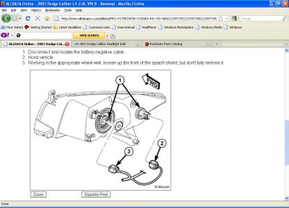

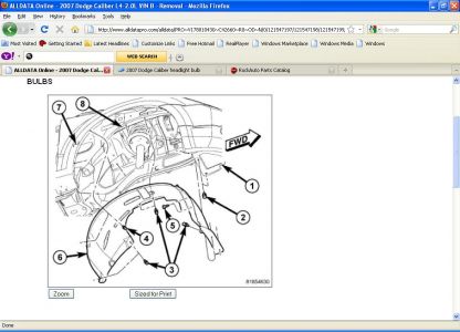

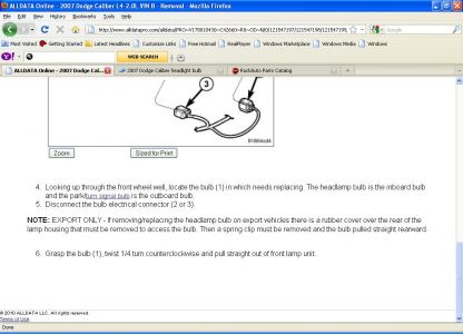

How do I remove the lheadlight light bulb to replace it?

There you go.
