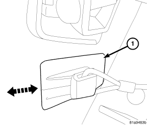

Where is the pollen filter located? And how do I change it

Remove glove box damper let it hang.
Disengage two retaining tabs
Remove filter
