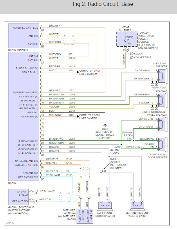

My 2008 Avenger's factory installed radio stopped working. It worked last night and this morning when I started it nothing like there's no power to it. Please help.
Wednesday, December 9th, 2009 AT 7:15 PM
9 Replies
MHPAUTOS
  • 31,937 POSTS

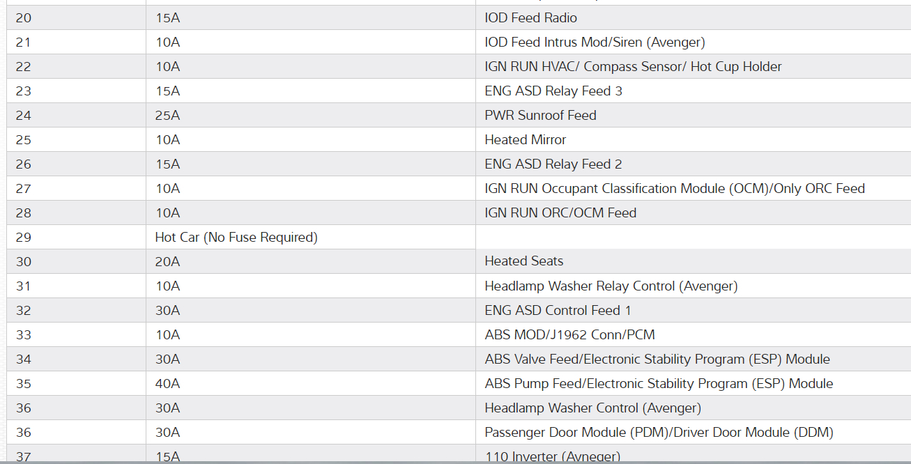

Hi there,
Check 2 fuses first, if they are ok, the problem may well be in the radio, and you will need to see if the unit has power and ground and if so the unit is bad and needs to be replaced I suggest an aftermarket unit cheap and easy to install.

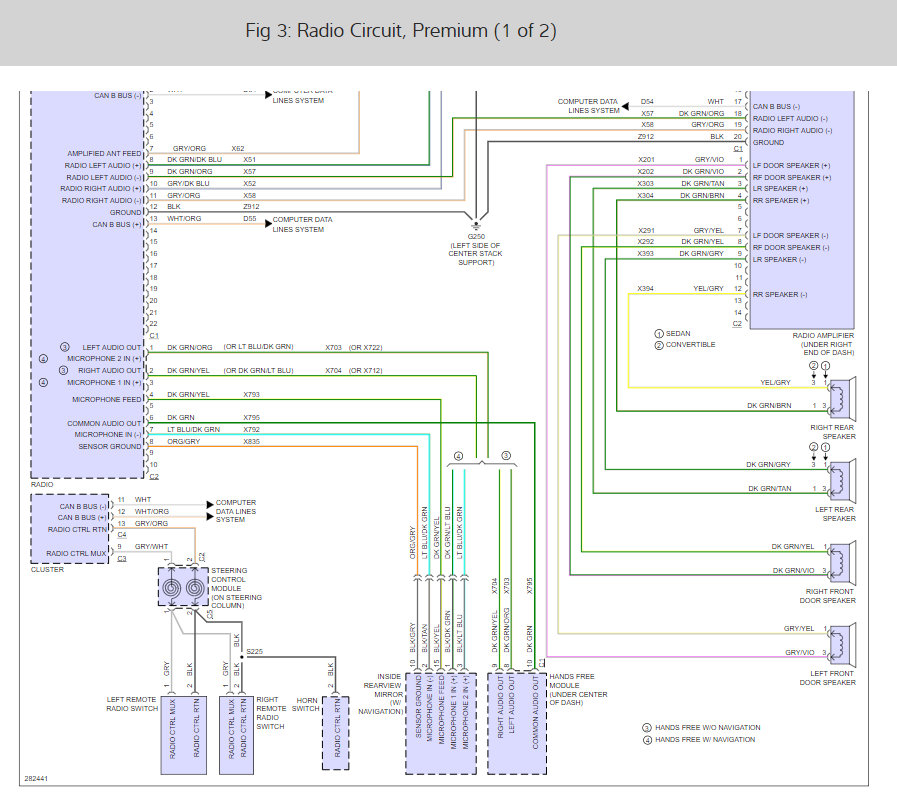

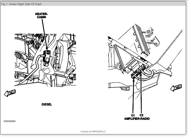

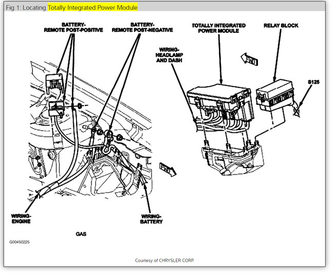

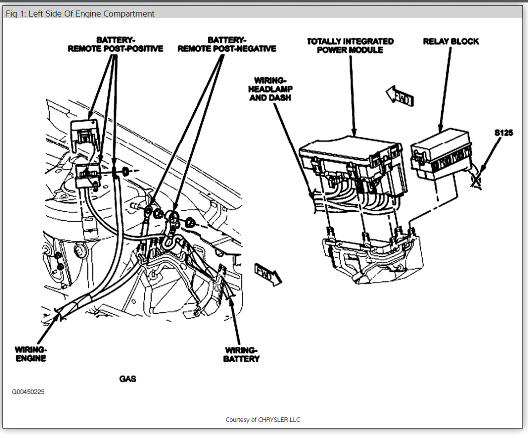

Here are some guides and a wiring diagram (below) to help you do some simple testing for power.
and
Please run this test and get back to us we are interested to see what it is.

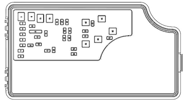

Radio and clock stopped working yesterday. Replaced the two mini fuses, thinking that was the problem, still not working. The fuses I replaced were under the hood. Can you please advise what this could possibly be? Is there an section inside where I should be checking for additional fuses?

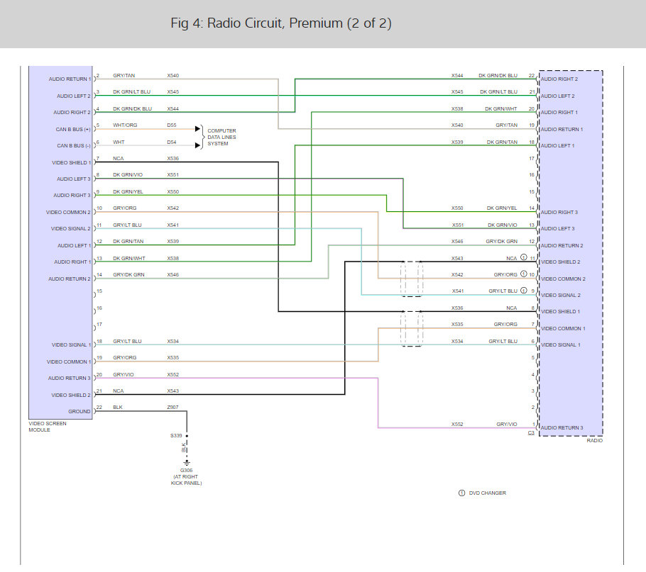

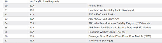

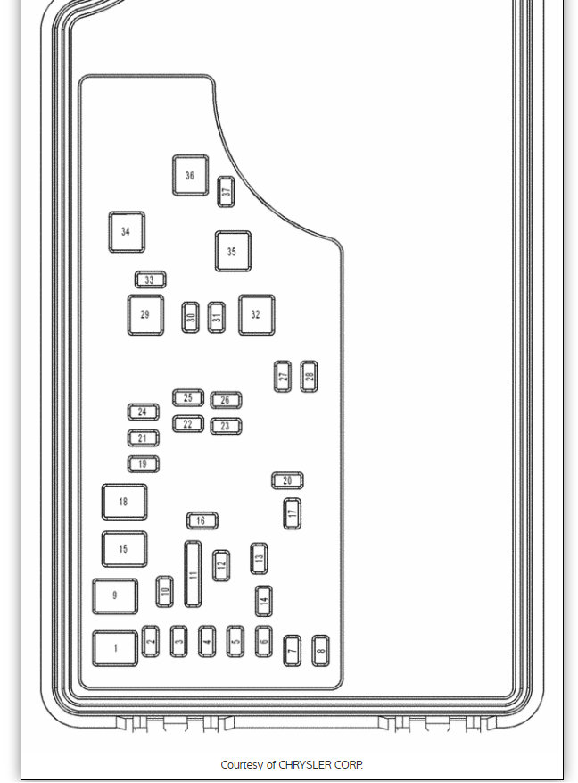

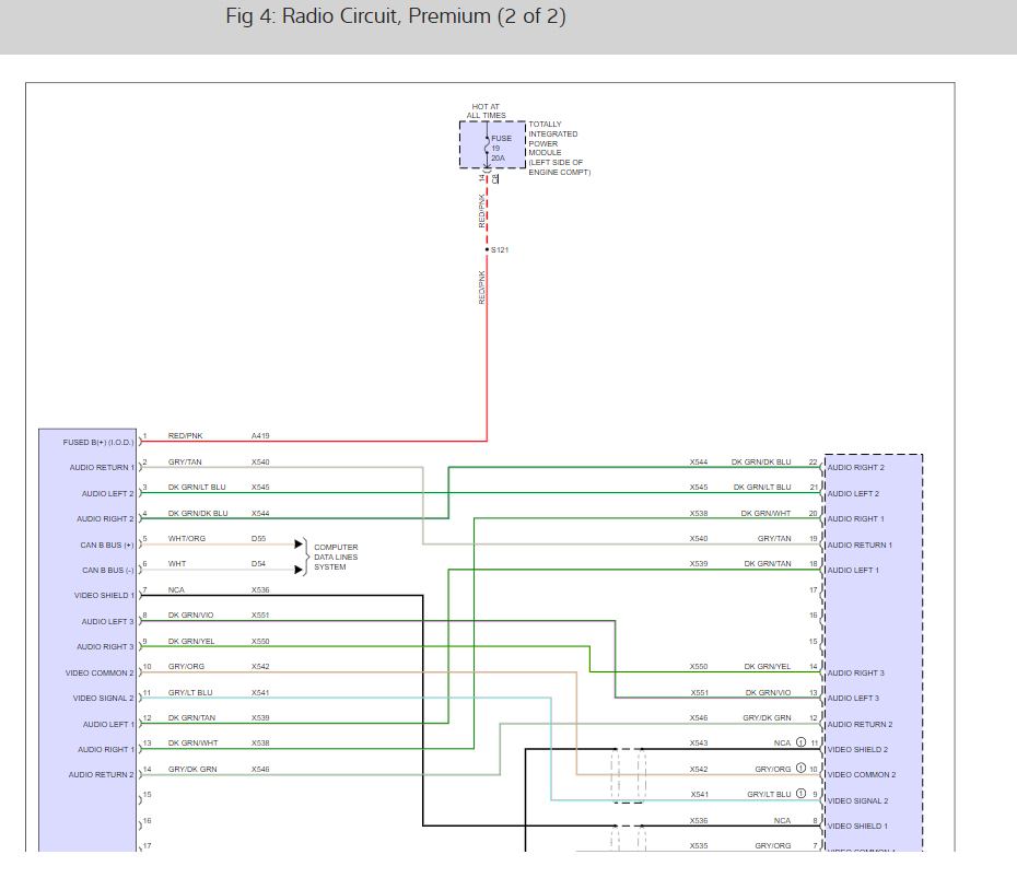

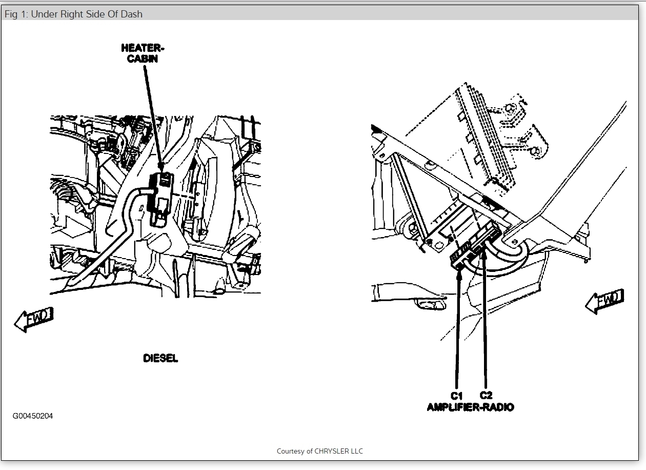

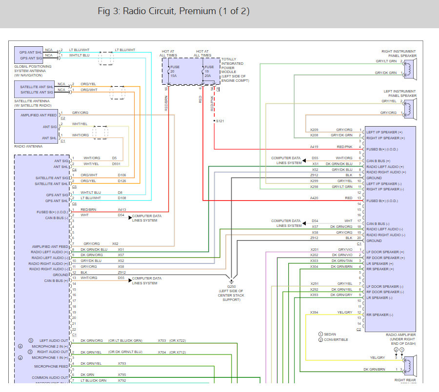

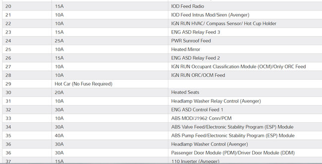

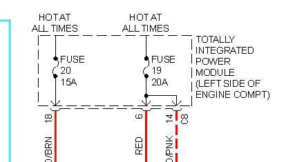

Hey Paula,

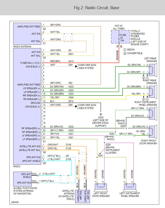

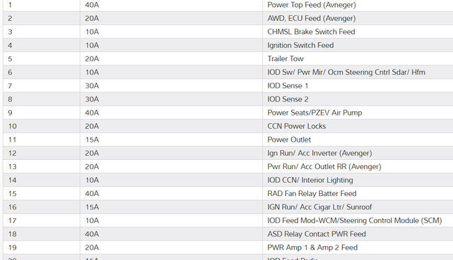

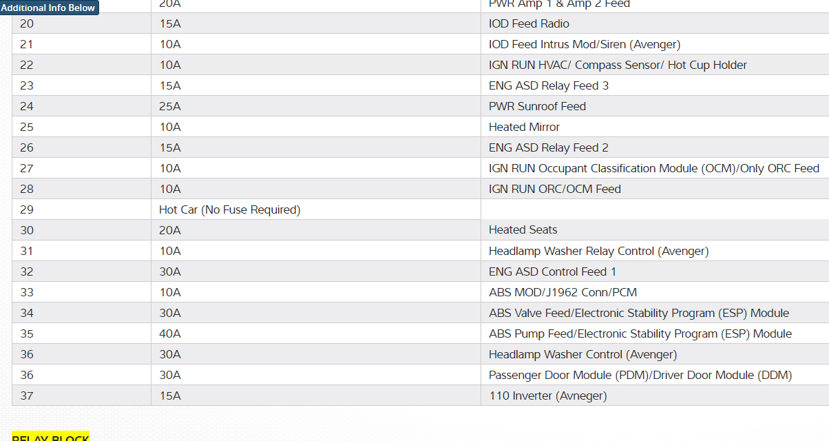

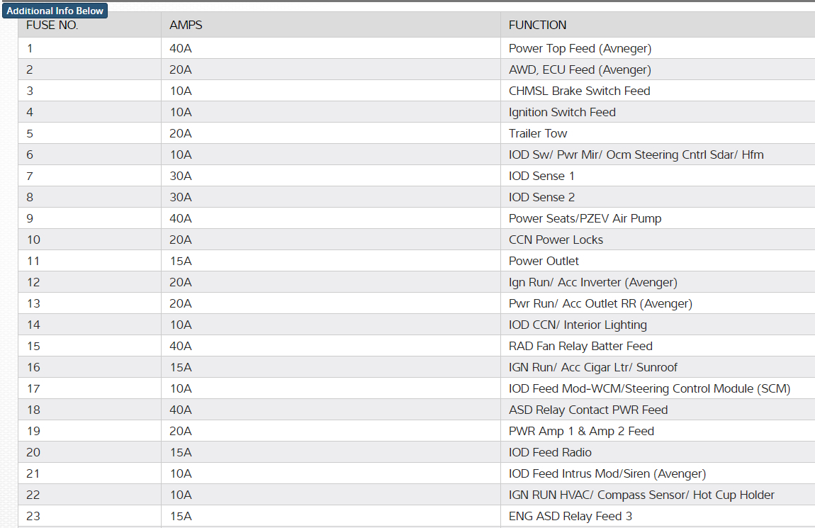

The radio is integrated with the power amplifier which share some circuits with the clock. I have included a wiring diagram which shows #19 fuses might be bad. Here are the radio wiring diagrams so you can see how the system works and the fuse locations with a guide to help you test.
Check out the diagrams (Below). Please let us know what you find. We are interested to see what it is.

Thank you for this post I checked the #19 fuse it was bad, replaced it and its all fixed! I love this site.
