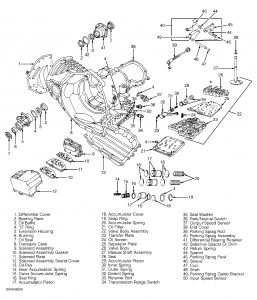

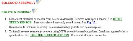

Where is this located need information on how to replace it
