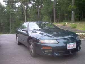

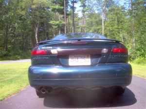

Rewired the radio (correctly), reset the computer and the ABS has not returned. Brakes are fine inspection was @ 100% thumbs up for your indebth advise..
dconant
https://www.2carpros.com/forum/automotive_pictures/153312_Copy_of_Copy_of_3nc3o13l55O35Rb5Sc994fa88358708dc1c96_1.jpg
https://www.2carpros.com/forum/automotive_pictures/153312_Copy_of_Copy_of_3k33o63la5Oe5P65Rb99418e0f33706391f88_1.jpg
Monday, March 1st, 2021 AT 11:18 AM
CH112063
  • 1,320 POSTS
What a nice car, be safe out there. Joe anytime
