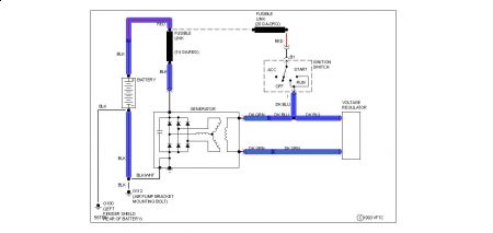

have tried 5 diff alternators still will not charge have checked all the grounds and the positive wires still no charge and the alternators test good on computers do you think the cars computer has went bad it does have the 90 amp alt with internal reg any ideas im at a loss tried everything i know

Do you have battery power at the alternator battery terminal? if not test the fusible link and also inspect wiring from the alternator to the ignition switch
