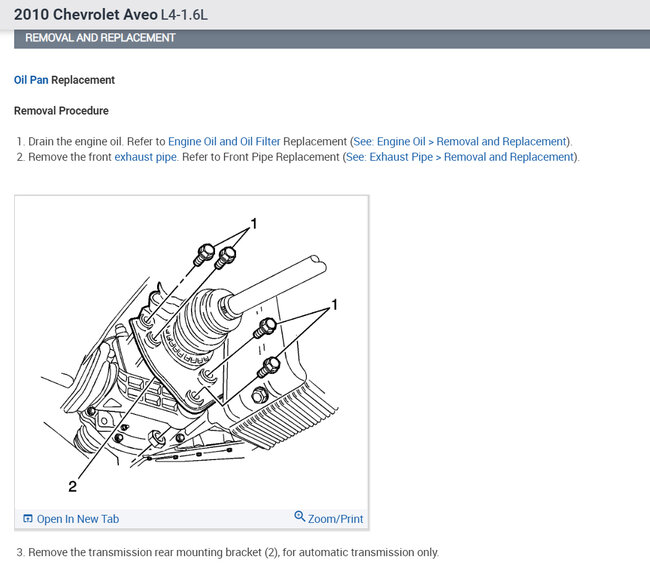

Do you need to support the transmission to drop the oil pan?
2010 CHEVROLET AVEO
78,000 MILES • 1.6L • 4 CYL • 2WD • AUTOMATIC
CHEVYOWNER10
  • 93 POSTS

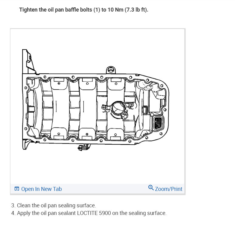

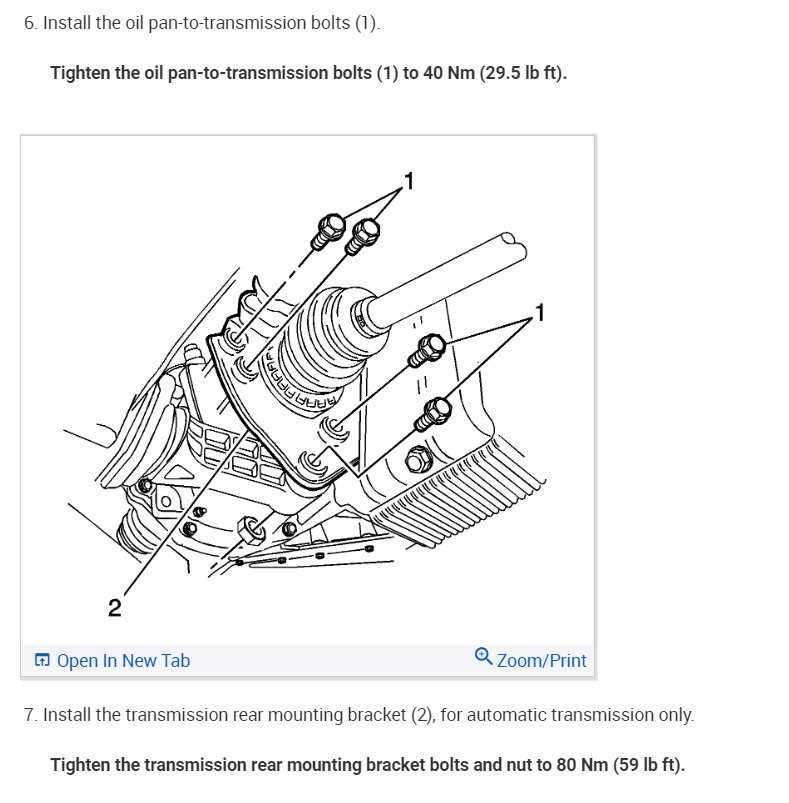

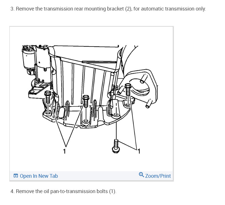

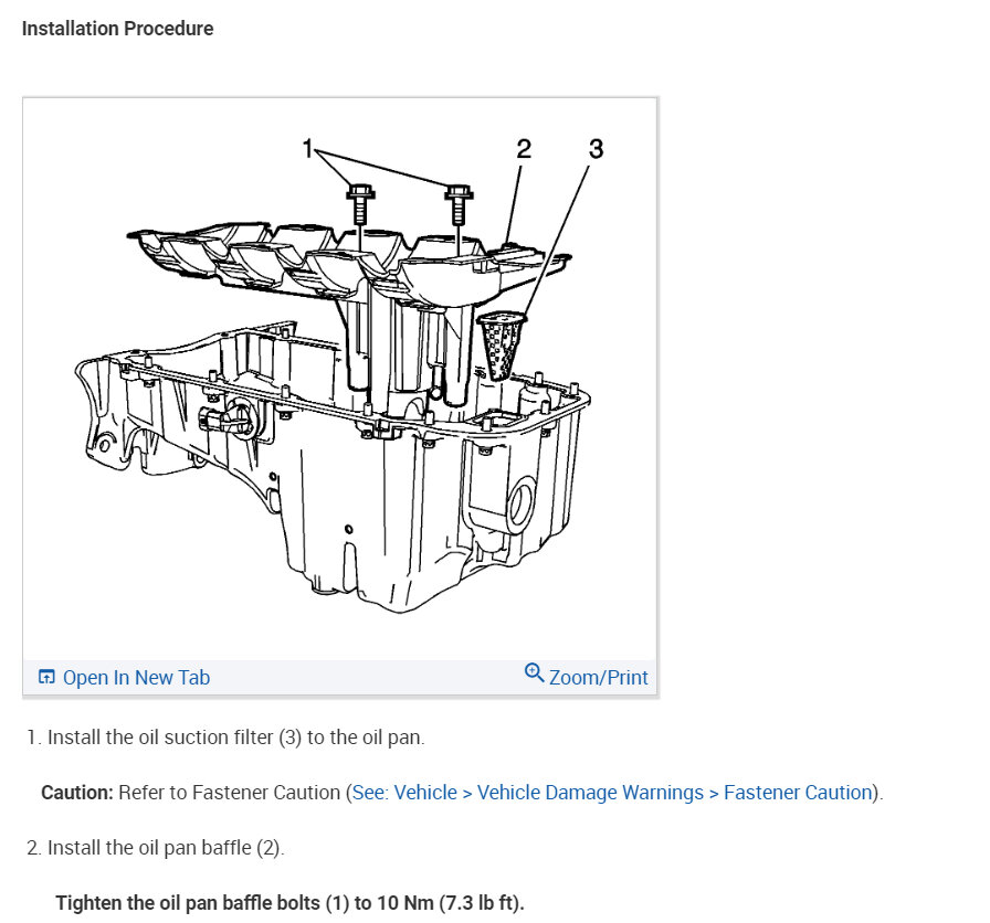

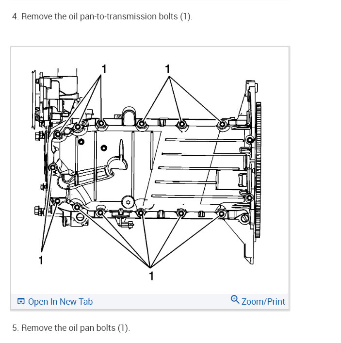

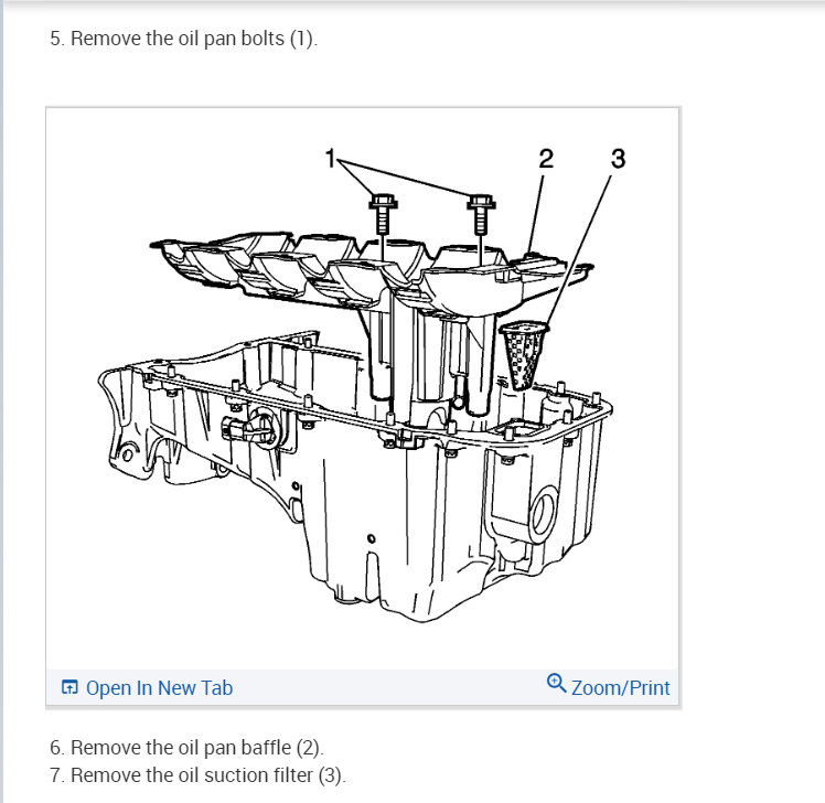

I was wondering there is 4 bolts connecting to the oil pan that connects to the transmission. I would assume you do not have to support the transmission to remove the oil pan because the torque strut and trans mount is supporting the transmission? Any idea?

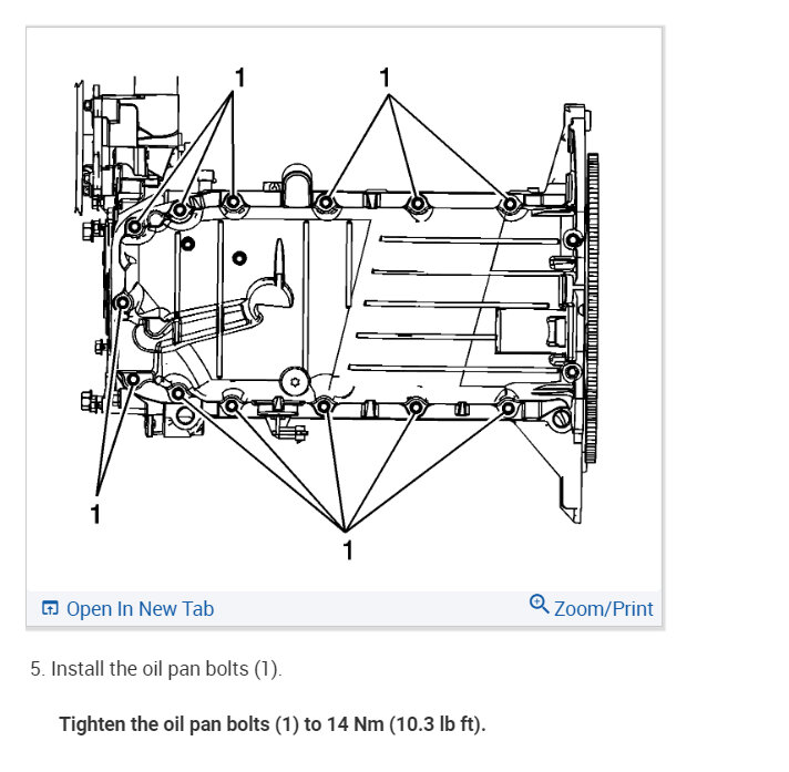

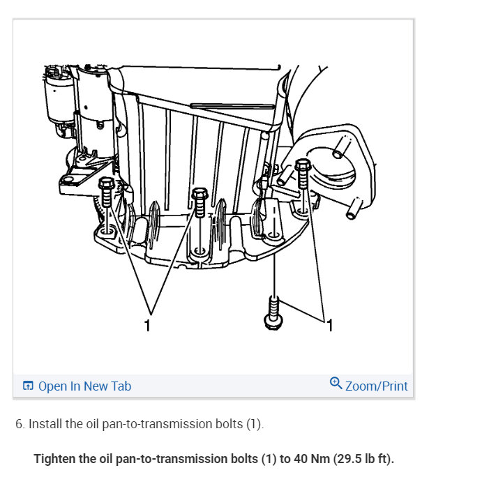

I also need info on what the torque specs is for the oil pan bolts.
Nov 7, 2022 at 1:26 PM
  • CAR REPAIR CONTRIBUTOR
  • 54,191 POSTS
You will need to remove the transmission oil pan bracket here are the instruction for doing the job with the oil pan bolt torque specs as well. I would start by draining the oil and disconnecting the battery. Check out the images (below). Please let us know if you need anything else to get the problem fixed.
