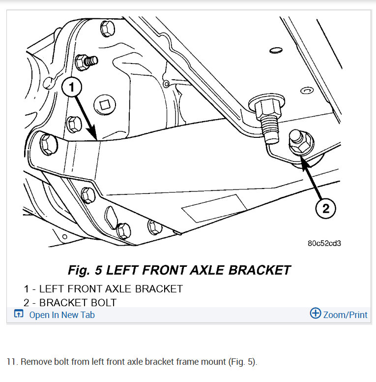

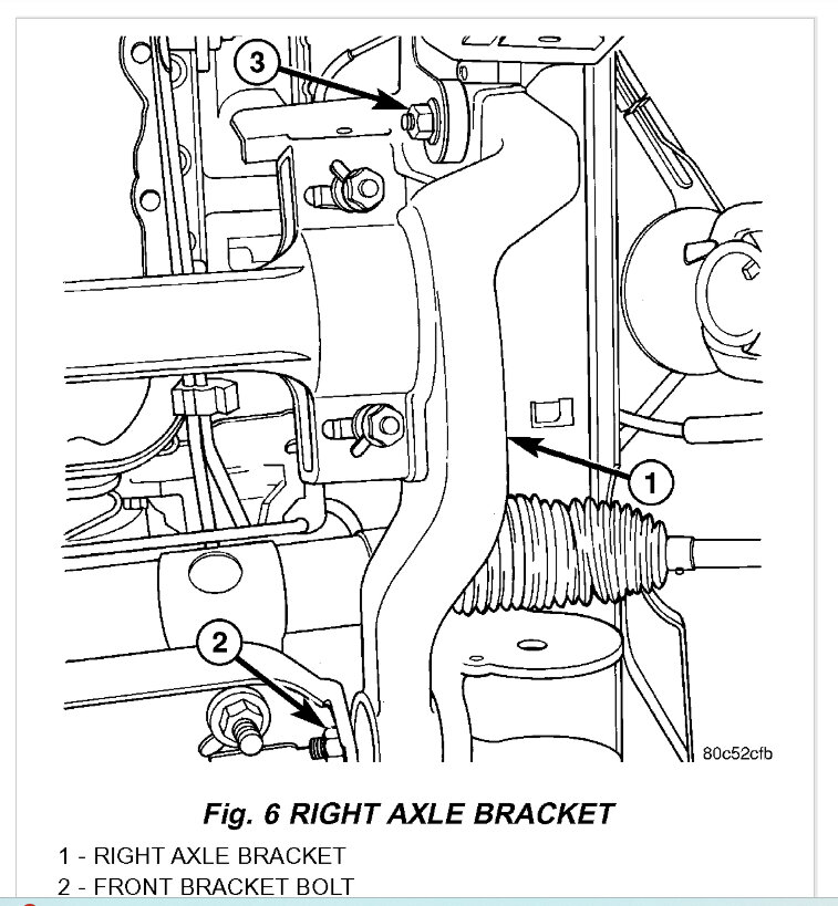

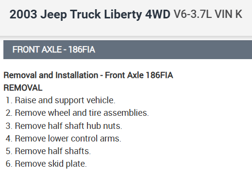

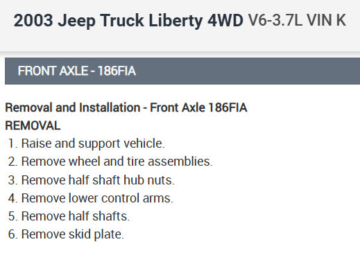

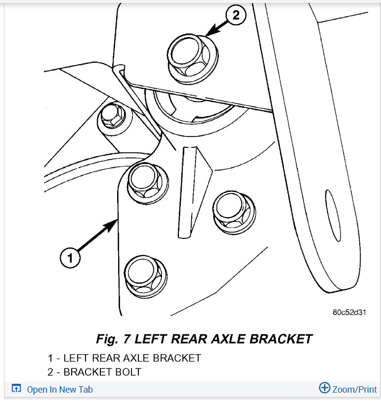

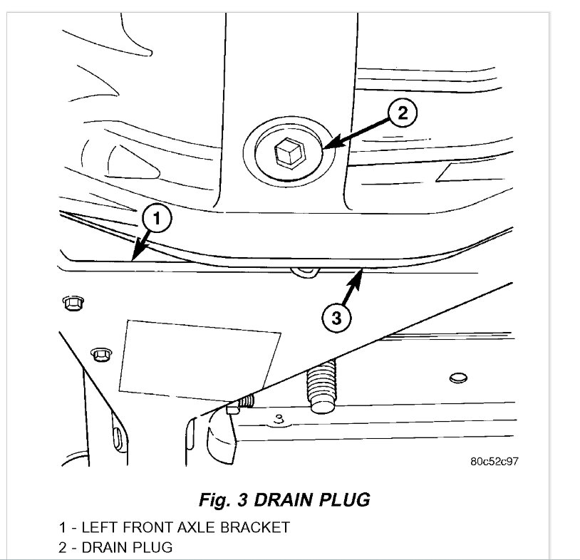

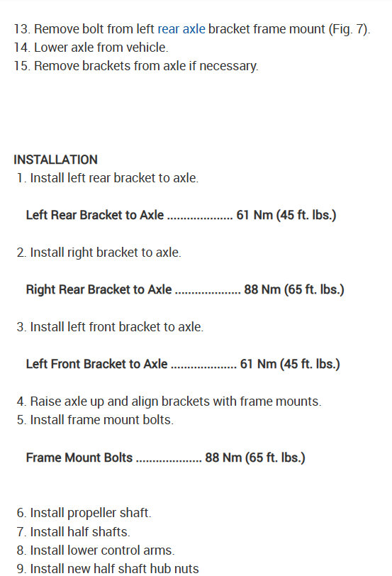

Yep, you are correct, if the CV axles are off and it still makes the noise I would swap the diff out. It sounds like one of the carrier bearings is no good. Here is how the job is done. Check out the images (below). Let us know if you need anything else.
