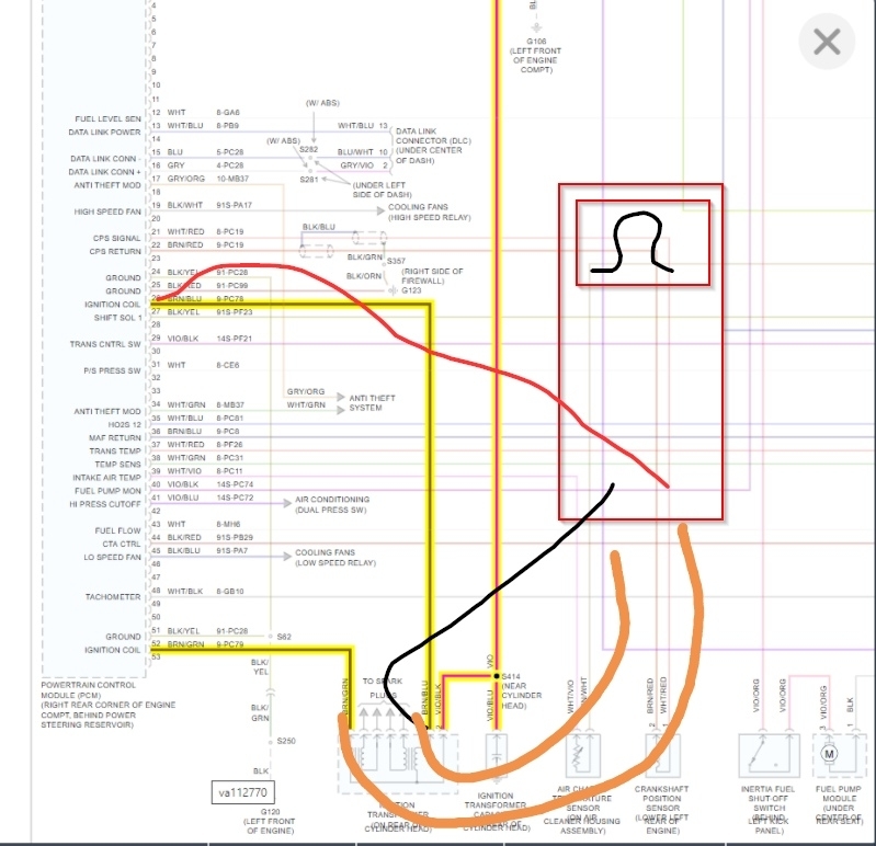

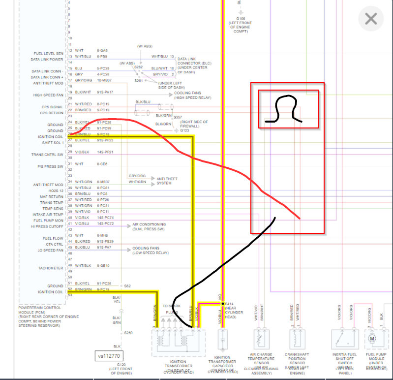

Can someone give me diagram or words explanation about the wiring of the ignition coil pack to be able to try put some new wires? Or tell me if that is normal to have one weak spark and one strong on the same coil. Because I bought new ignition coil pack, cables are almost new (also tried with another set) and there is still weak spark on 1 and 2, and strong on 3 and 4. It is noticeable, because when cable is removed, on 1 and 2, spark starting to jump only on 1-2 cm away of spark plug and is almost not noticeable, what is not case on 3 and 4 where the spark jumps about 10 cm anywhere and is strongly noticeable. Thanks
Monday, September 27th, 2021 AT 2:57 AM

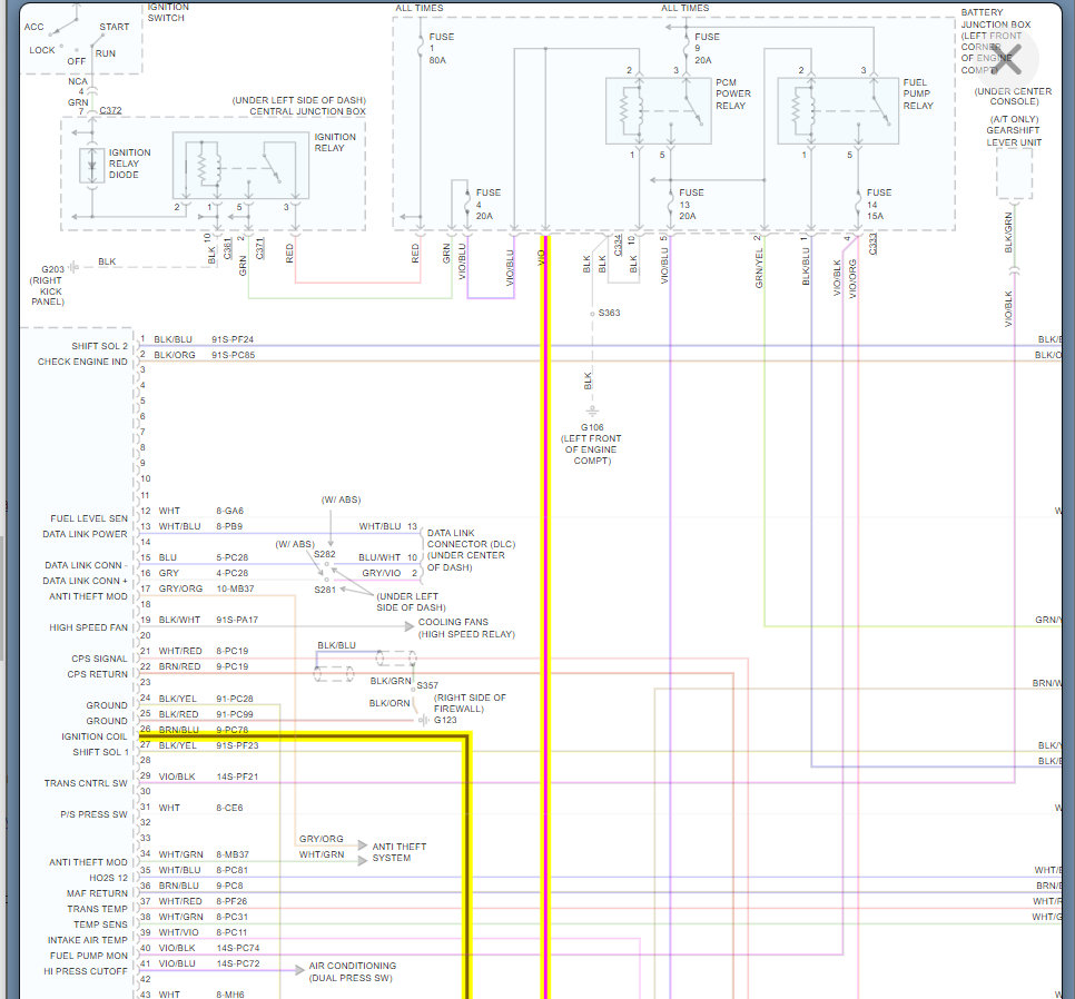

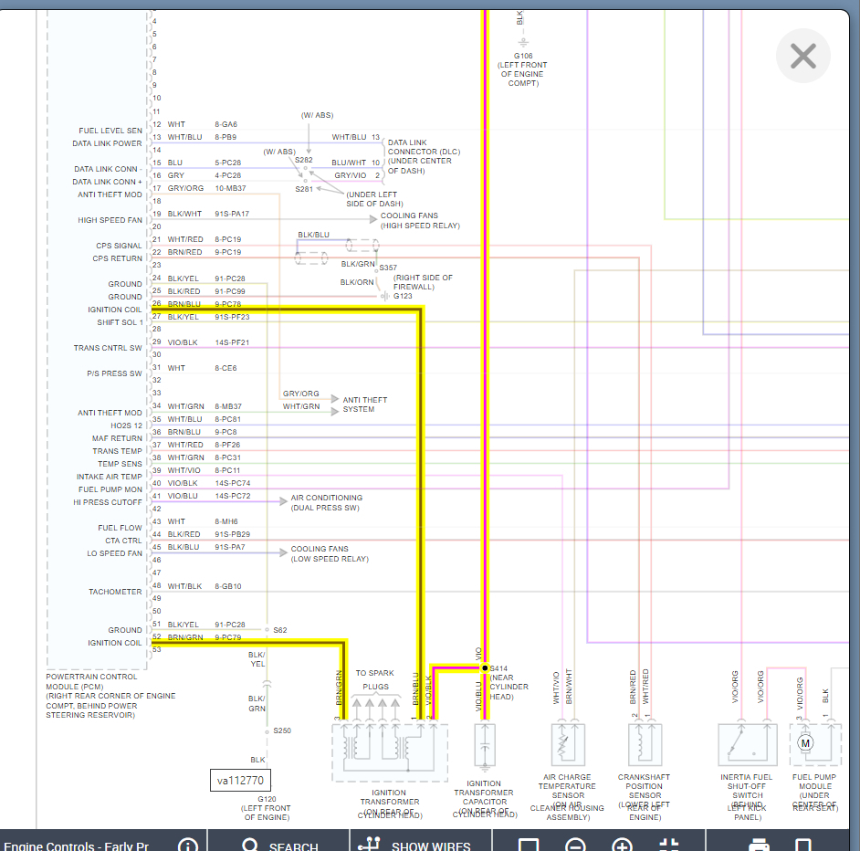

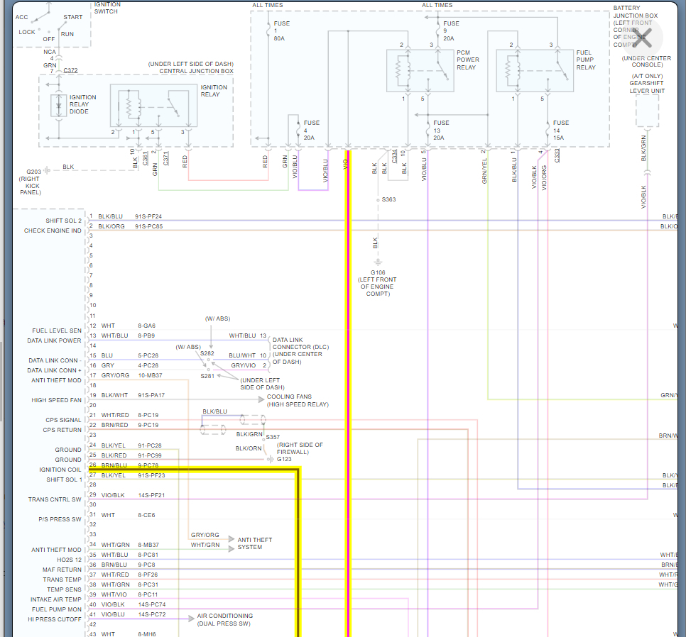

The way this works is power (12 volts) is supplied to the coil through the violet and black wire. The fact that one side of the coil is fine and the other is not shows that this 12 volts is not the issue.
However, the coil then takes this 12 volts and when the signal is interrupted by the PCM it creates high voltage and sends this to the spark plugs.
What I would do is measure the resistance in the two wires coming from the PCM to the coil and make sure it is less then a half ohm in each wire.
You do this by disconnecting the circuit at the coil and PCM then set your meter on ohms and probe both ends of the circuit and see what the meter says.
Here is a guide that covers this.
If the wires both show less than a half ohm of resistance then more than likely the issue is in the PCM that is no interrupting the signal so you have 12 volts going to the plugs rather than the high voltage needed.
Take a look at the wiring diagrams below.
Thanks

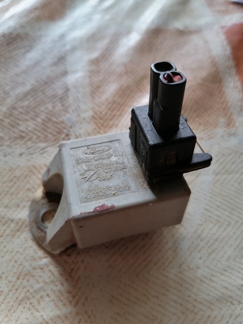

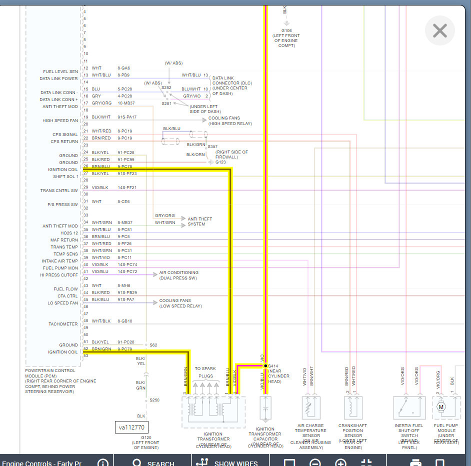

Dear, thanks for your answer and for your diagrams. I am going to do the measurement tonight after work and give you a feedback answer. As I understand you, I should measure the resistance between the two (as I think ground) points that come from PCM, because the center wire is common + for both coils in the pack. Here I would ask you one (between) question. Can the ignition capacitor somehow affect the spark? Because as I can read on internet it is only for radio interference removal. And mine is removed, because when I bought the car, it's wire was cut and it was just screwed, so when I replace the coil pack, I dismounted it. I mean for this capacitor on the photo attached.
Tuesday, September 28th, 2021 AT 4:41 AM
That is correct. Unhook the connector from the coil and PCM and put your leads on both ends of the wire and measure the resistance (ohms).
As for the capacitor, it would not cause this issue on just half of the plugs. It is there to reduce the "noise" on the circuit so that you get a good clean signal.
If yours is removed, it is a good idea to reinstall it, but I doubt that will fix this issue.
Take a look at the diagram and I marked on the diagram to try and help explain this.
Thanks

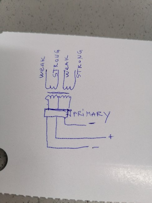

I thought that I should measure these two points as showed in attachment. But in this case as you attached, I should remove the PCM and measure the resistance from one wire end to other wire end as I can understand?
Tuesday, September 28th, 2021 AT 12:18 PM
That is exactly correct. The way in which you are showing is testing the coil for an open circuit within the primary windings.
That is a good test, but I don't think that is your issue because you are getting spark on all four plugs just weak spark on two of them.
So that means either the new coil has an issue with the secondary wirings or the PCM is not opening that ground side to cause the field collapse for the voltage spike.
Basically I think you are going to have no issue with the wire and the PCM is just never opening the ground side when those plugs are supposed to fire so you never get the high voltage spike.
Clearly this is all going off the fact that you are seeing a weak spark.
With a new coil doing the exact same thing, either the spark is not weak or the PCM is not spiking the voltage.
Take a look at the info below.

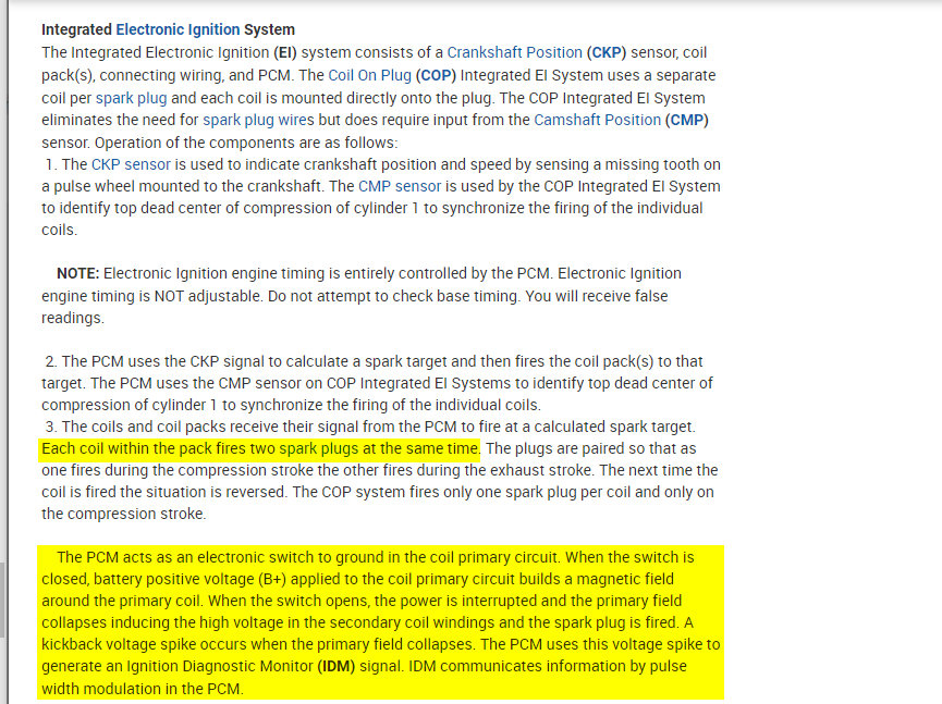

I also found this on Google about that capacitor, is it true?
Tuesday, September 28th, 2021 AT 2:20 PM
This is not true. The condenser or capacitor is only there to absorb excess current flow. It does not deliver high voltage or amplify it. That is solely done by the coil.
There are two main reasons for this part. First if there is excess current from other sources, it absorbs this current so that the signals are not interrupted.
The second is so that there is no arcing in the coil when the PCM interrupts it.
So now that I say this, how long did it take for the new coil to have a weak spark? I understood that it was immediate. Meaning you had weak spark, put the new coil on it and still had weak spark as soon as you started the engine.
If you have no capacitor then the coil will eventually fail because when the PCM interrupts the signal in order to create the high voltage, the current actually tried to jump across the coil and it can burn them up.
Normally this takes a little bit of time which is why I said it would not cause this. However, if you don't have one it may be the cause of the coils failing.

The weak spark was from the beginning of time using new coil pack. Also, as I mentioned, it is not weak spark from one coil, but weak spark from one side of both coils on the pack. As I mentioned before, weak on 1 and 2. Also I tried swap test, and when I swap the plug cables, I got weak sparks on 3 and 4, strong on 1 and 2.

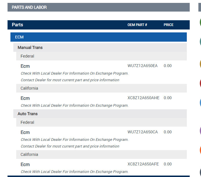

Okay. So, I read back through this, and I want to confirm. You had the original coil on the vehicle, it had this same issue. Then you replaced it for this issue, and it still is the same?
I just want to double check that the coil was not replaced for another issue and now you have this issue on the replacement coil.
I am attaching a video on how to check the coil. This test is being done on a coil on plug style, but the idea is the same on your coil pack. Clearly, we are only going to have two to test rather than doing each individual.
https://youtu.be/1zQQy9noYQ0
The fact that you can swap the plugs around and it is still the same ports on the coil just shows that it is either the coil, wiring, or PCM.
We need to run through these tests but if the coil was replaced for this issue and the new coil is doing the same thing then I would replace the ECM or send it out and have the circuit board checked and repaired.
