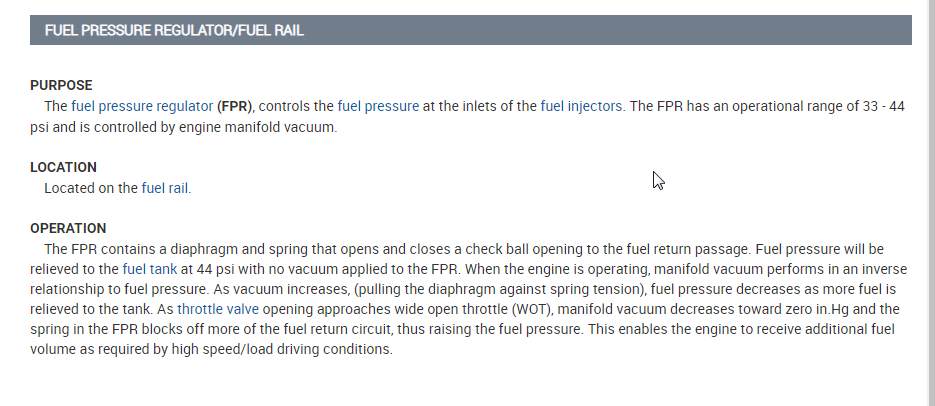

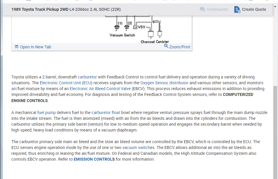

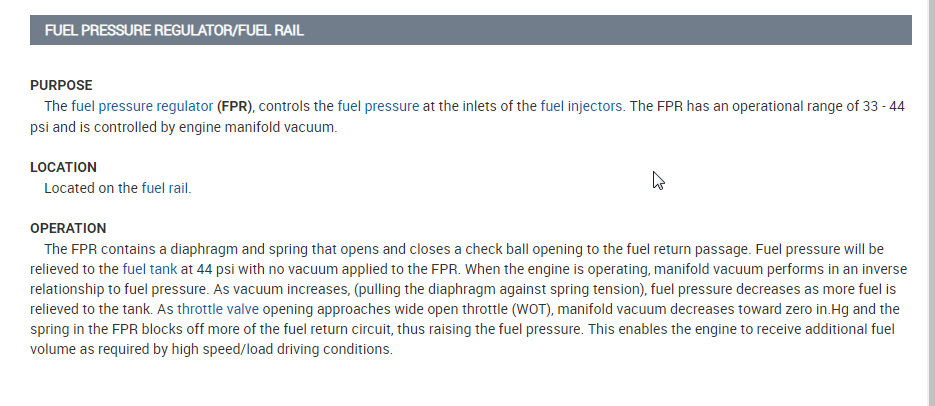

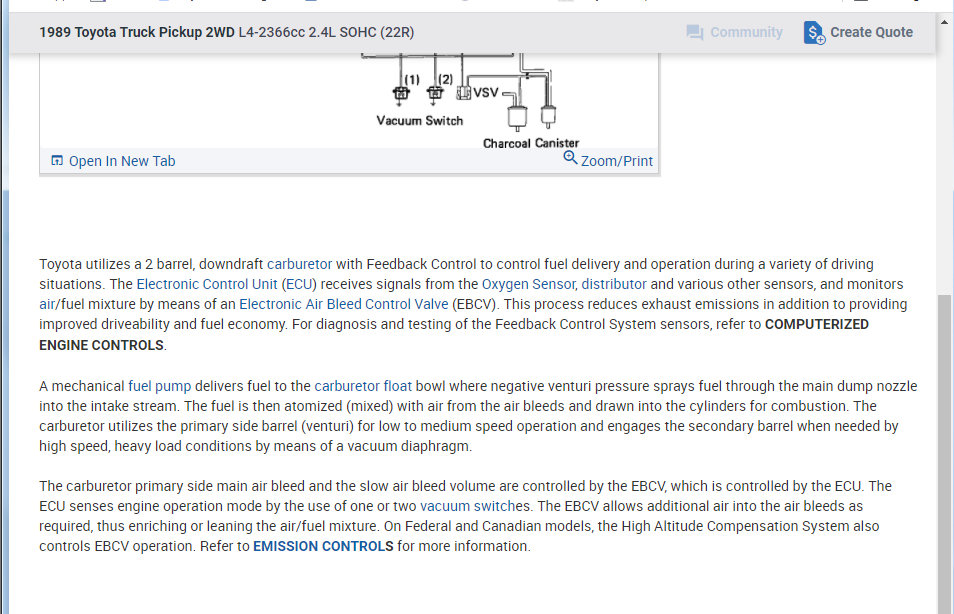

What's the differences between a 22R and a 22RE engines?
Saturday, May 1st, 2021 AT 8:26 PM
MECHANIC
18,907 POSTS
The "E" denotes EFI or electronic fuel injection. This means it has a throttle body and fuel injectors and not a carburetor.
I attached the info about the fuel systems below. The first is the RE and the second is the R.
Please let us know if you have other questions. Thanks
