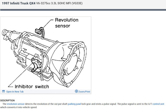

Hello, can you show me where my input/output speed sensor is at on my listed above? I've watched video and I can't seems to find the sensors.

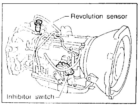

There is a front and rear revolution sensor, one is in the side of the transmission and the other on top near the rear. Check out the images (below). Let us know if you need anything else.
