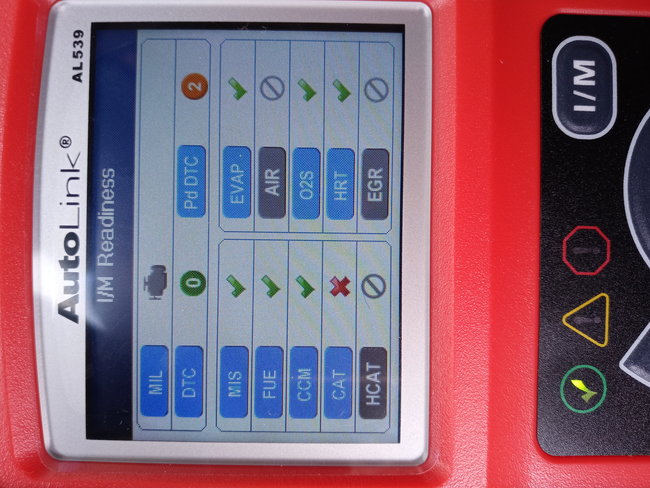

Okay, one more question. So if I would have dtc code I won't pass? I'm trying to find one for future what I should pay attention to. Thank you, ev

If you have a code, it will not pass. That is correct.

Okay, so failed inspection with dtc code but I can have pddtc code right and I can pass with that? Thank you, ev

Correct as I stated before.

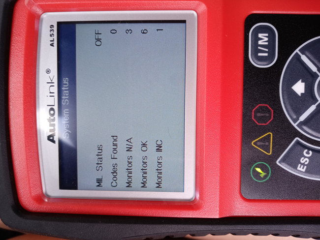

But my engine light is not on though? I know I pass inspection with 2 codes in NJ before it was years ago. I don't remember the codes though. My other question is, it is says that the car is ready for emission based on green light on the images or not? Thank you

Hello again.
Green checks mean they are good and ready to go.
The codes are inactive at the moment. They will become hard codes at some point and turn on the light.
