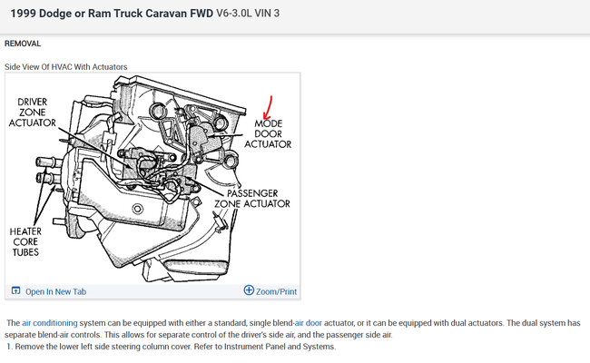

No heat/defrost when heater is on.
AC not in play
Jan 28, 2025 at 4:58 PM
  • 54,503 POSTS
Okay, I assume you don't have any heat with the hater on as well. I would remove the mode actuator and work the blend door by hand to see if you get heat at the defroster. If the actuator is weak it will not move the controls completely. Here is the location, let me know what happens.
