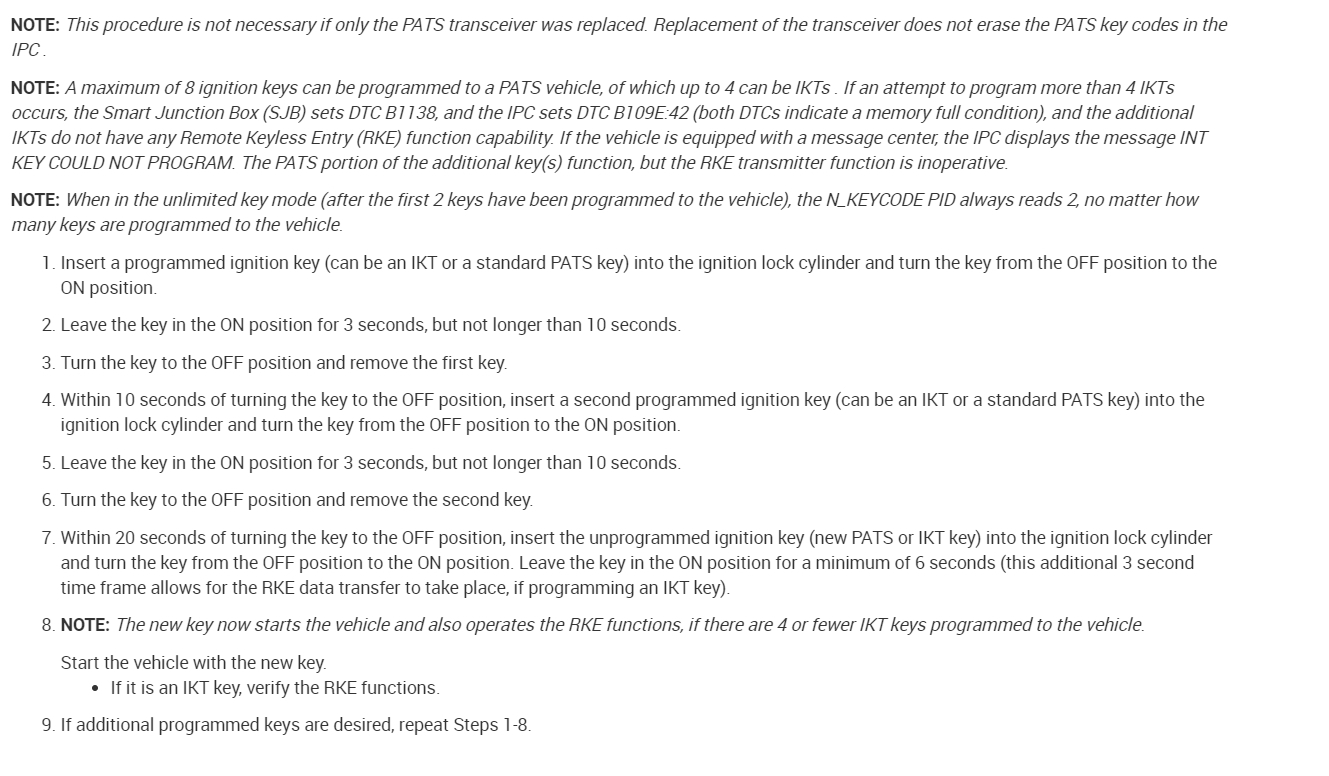

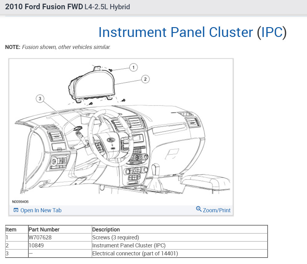

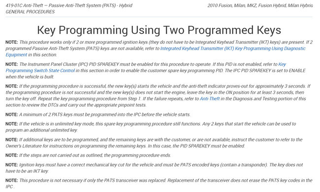

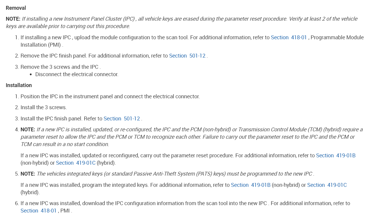

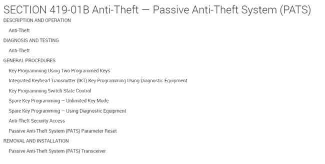

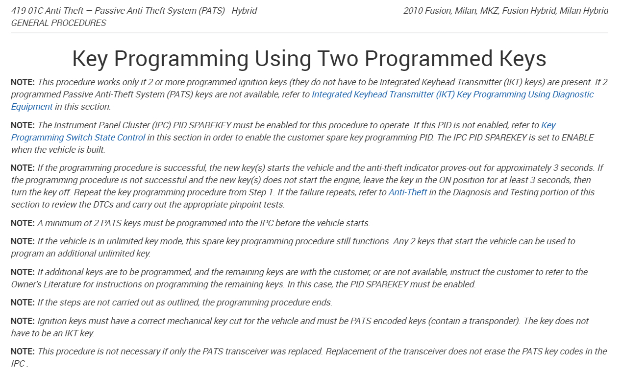

It sounds like the instrument cluster is going out. To be sure we need to do a CAN (controller area network) scan which scan which is easy to do to confirm the problem. You can get a CAN scanner from Amazon for about $30.00. here is a video to show you how. I have included the instructions on how to change the IPC (instrument panel cluster) out in the images below in case the problem is confirmed by the CAN scan. You can find a rebuilt IPC by searching google or Ebay.
