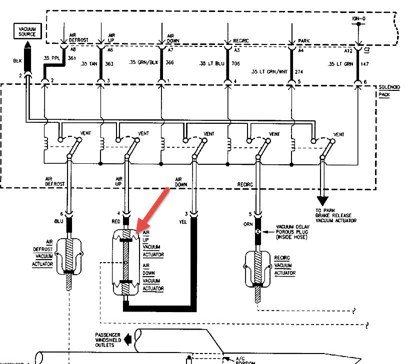

Heater or air conditioner functions properly, but blower only blows through floor vent or defroster. Wont switch to dash vents.

Check for a vacuum leak or vacuum motor not getting vacuum to open to proper position it can start at control or engine or a hose.
