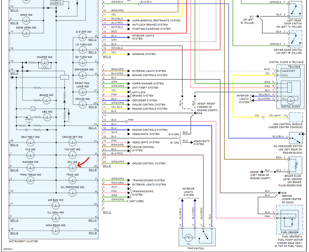

Maybe, you are supposed to have a check engine light bulb. Here it is in the cluster wiring diagrams, does it look like it has been removed? I would get another bulb and holder and install it. There might be trouble codes which is why it was removed. Did you buy the car new or? Check out the images (below). Please let us know what happens.

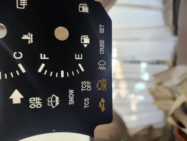

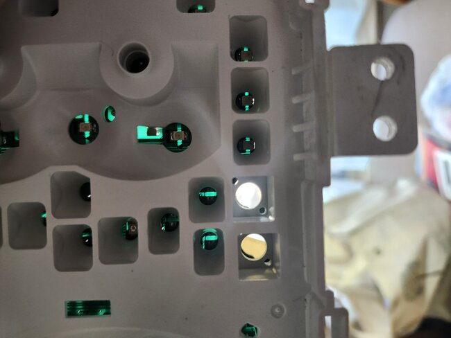

DAVID NORRIS
  • 8 POSTS
Was bought used and this is the first time I've had any problem with inspection. Disassembled and there are no LEDs installed under cover. Apparently never installed. Thanks for the answer.
Sunday, January 19th, 2025 AT 11:11 AM
DAVID NORRIS
  • 8 POSTS
This is my gauge cluster. There are no LEDs installed.
Sunday, January 19th, 2025 AT 11:19 AM

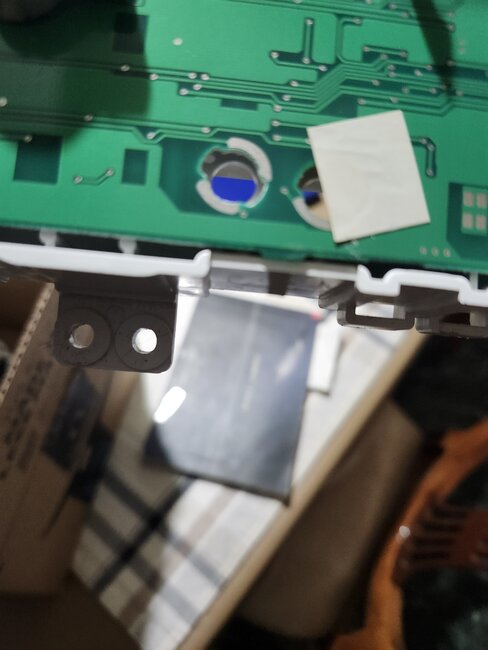

DAVID NORRIS
  • 8 POSTS
Here's ther back of the board.
Monday, January 20th, 2025 AT 6:42 PM
KEN L
  • MASTER CERTIFIED MECHANIC
  • 55,266 POSTS
Those are bulb socket holes, I can't tell if there is a conductive metal surface at the socket hole, or is it just board? This is what should be in there if there is a conductive material. Check out the images (below). Please let us know what happens.

KEN L
  • 55,266 POSTS
Is there a conductive metal surface at the socket hole, or is it just board? It is hard to tell from the image?
Wednesday, January 22nd, 2025 AT 8:37 AM
DAVID NORRIS
  • 8 POSTS
Yes, there is a conductive area on the top.
Wednesday, January 22nd, 2025 AT 8:48 AM
KEN L
  • 55,266 POSTS
Yep, it looks like someone removed it, good find, let me know if it starts working once you get the replacement bulb and socket.
