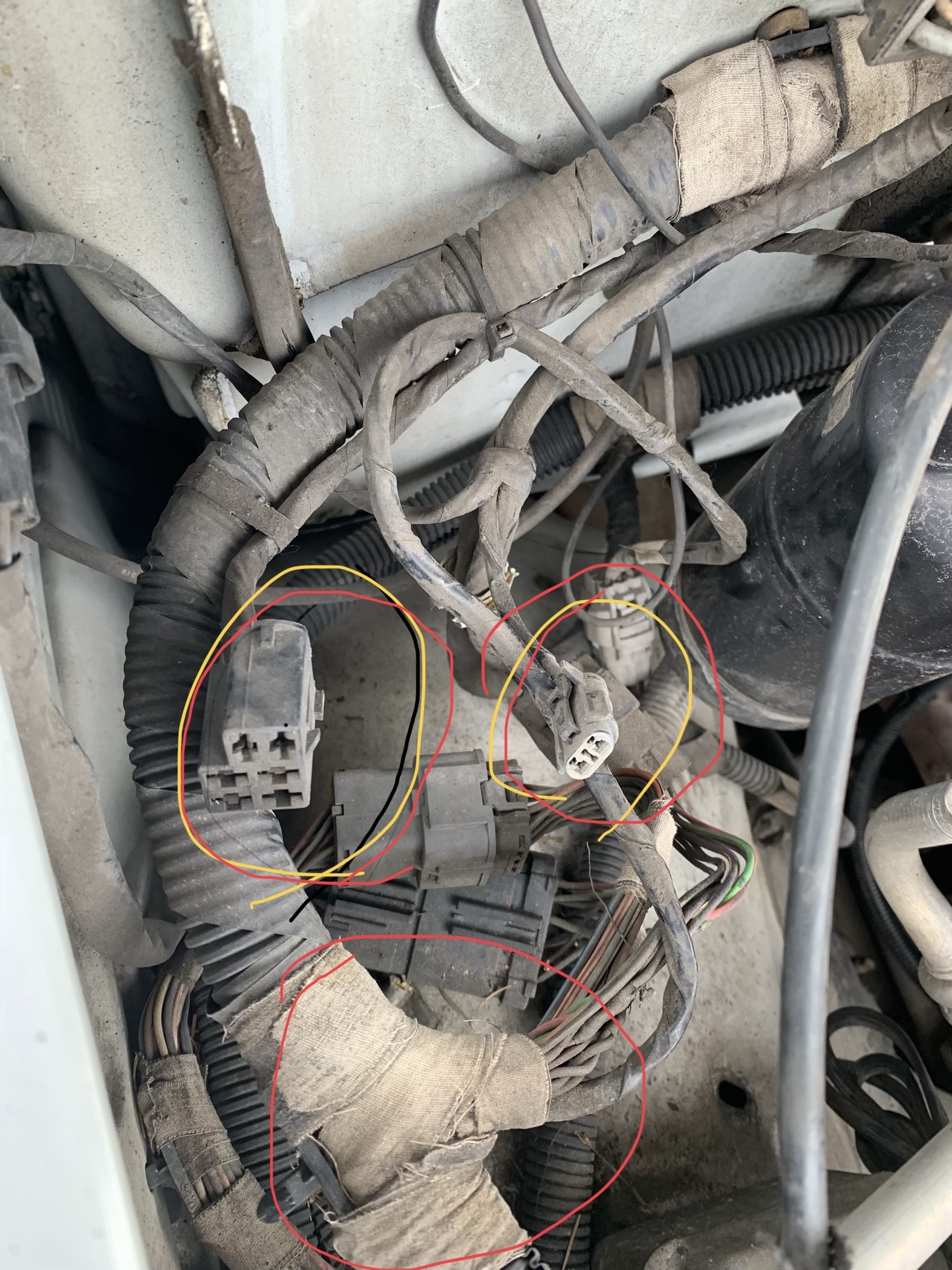

For the last two months my vehicle has been randomly stalling. When it does it usually will crank over but not start. There is no code or check engine light. One shop did get a general ignition code somehow. I was looking for a damaged wiring harness. I lifted the splice and the engine rpm's shot up. I also noticed the connector on the right is not connected to anything. Does anyone have a clue where it goes to? This is my first time electrical troubleshooting.

That's the diagnostic connector, but that was only used up through '95 models. Vehicles with the newer "OBD2" emissions system all have the diagnostic plug under or near the steering column. Typically there will be a black plastic cover hooked to the wiring harness to protect that plug when it's not being used.
Will the engine start if you hold the accelerator pedal down 1/4"? If it does, the most common cause of this low idle speed is the battery was recently disconnected or run dead. The Engine Computer needs to relearn "minimum throttle", but to do that, a specific set of conditions must be present. To meet those conditions, drive at highway speed with the engine warmed up, then coast for at least seven seconds without touching the pedals.

Initially it starts just fine. I can’t make it 2 blocks before the engine dies. It will not restart by pressing the accelerator down until it sits overnight. I’m thinking my issue is in the splice in the photo.

I can't tell from the photo, but if you can change idle speed by wiggling it, that is a good suspect. It's not uncommon for moisture to sneak into a splice and corrode it.

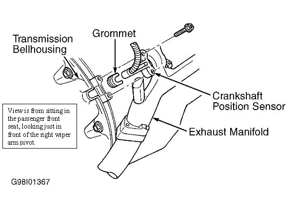

The common causes of intermittent stalling with a failure to restart are the crankshaft position sensor and the camshaft position sensor. The cam sensor is inside the distributor. The crank sensor is behind the rear of the right cylinder head, in the transmission bell housing. Both of those often fail by becoming heat-sensitive, then they work again after cooling down for about an hour.

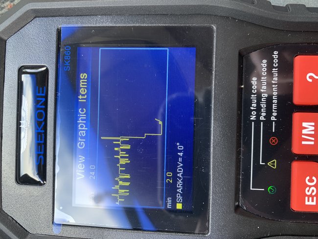

I pulled the map sensor. The connector is in good condition. I tried to clean it the best I could. I also looked for a vacuum leak, but there was no sign of one. The spark advance dropped significantly when it tried to stall while idling. That is the graph I was on when it happened.

CARADIODOC
  • 34,489 POSTS
The better things to watch are the crankshaft position sensor and the camshaft position sensor. If either of those signals disappear, the Engine Computer is going to turn off the automatic shutdown, (ASD) relay. That removes the 12 volts feeding the injectors, fuel pump, and ignition coil, so spark will drop out. It is hard to tell on a graph if spark stopped because the ignition coil failed, or because something else failed, then the ASD relay got turned off. You would have to be watching all three at the same time. Given that those two sensors have a very high failure rate, and ignition coils have a real low failure rate, it is the two sensor signals you should be watching.
Your scanner should have some means of showing whether or not those signals are showing up during cranking an engine that will not start and run.
